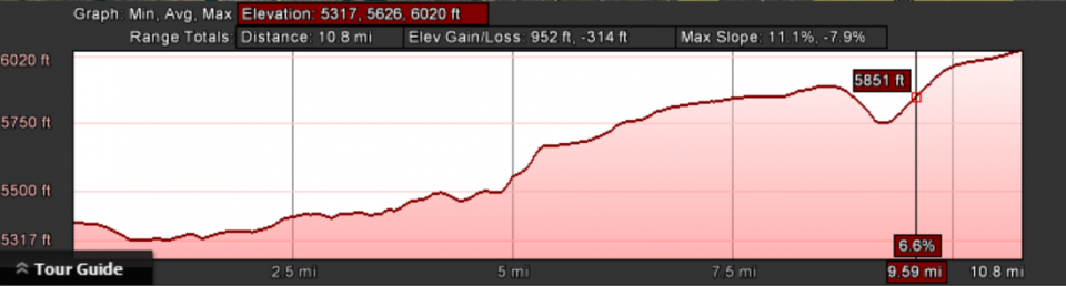

    I don't have a way to do video but here's what I did this morning.
    Car in 48F garage all night, on charge.
    Pre-condition using remote A/C for 5 minutes.
    Back out of garage and start down the street, temperature outside 28F.
    When I got off my block, I engaged cruise.
    I used cruise to get to the highway, entered the highway via a steep uphill entrance to 65mph. Engaged cruise, see image below.
    Drove on the highway until battery at 45%, then drove at 45mph with cruise until battery at 38%, all on cruise.
    Charged from 38% to 77% outside.
    Had car at dealer for maintenance for an hour.
    Charge at 75%, temperature now 22F, drove to work which starts flat and then involves a slow climb followed by a flat followed by a major climb.
    Got to work with battery at 7%.
    Never tripped out of Ev.
    #25 Lee Jay, Dec 18, 2017
