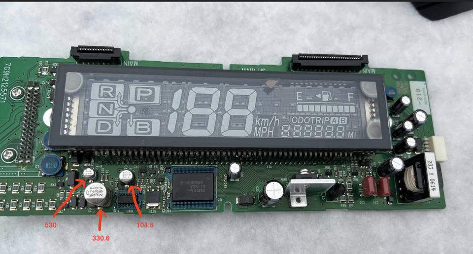

    I wanted to get some direct information on the capacitor readings I am getting now that I also took out my combo meeter due to it working intermittently.
    I tested the 3 capacitors on the far left and a bit confused on the readings. Here are the readings for each and a photo for reference.
    10uf 35v read 530
    100uf 16v read 104.6
    330uf 35v read 330.6
    So I read that the acceptable range on the capacitors is +/- 15-20% and can tell the 330 and 100 are good since they are reading at or near the acceptable range BUT the 10uf is reading way off, in the 500 range as a whole with NO decimal (unless I am reading the multimeter wrong). All read 3 numbers within their spec plus a decimal amount but the 10uf does not.
    I read that unless the readings are way off on the capacitors, they are good but curious as to whether I should still replace them or not as most videos I have seen only replace the 100uf with a 220uf 16v (which I have) and it all works again.
    Any help or link to a video where someone is actually testing the capacitors with a multimeter would greatly help. Also, I recall seeing a video (i cannot find it now) where someone also replaced other capacitors on the combo meter using the 220uf 16v capacitor but tond recall which ones.

    You are overlooking the most important thing to check with electrolytic capacitors. You need to check their ESR. I've redone many of these now. Typically the 100uF cap has low ESR, but the 10uF is often even worse. The 330uF usually checks ok. Given they cost less than a dollar each, I replace all 3 to be safe. Yes, there are lots of people blindly replacing the 100uF with a 220uF. This makes no sense. These and all electrolytic capacitors loose their ESR because the electrolyte dries up as a result, of time and heat. The best prevention from loss of ESR is to use high quality, high temperature, and a higher voltage if possible. When I replace these I use genuine Panasonic automotive grade, high temperature capacitors, and use a 25v instead of 16v for the 100uF cap. I purchased them from Mouser. Part numbers below.

    I replace all three because I'm in there. I used the recommended values (including the 220uF) and it works. Yes, if needed you can go to a higher voltage value. That's enough for me.

    Well, I ended up just replacing the 100uf as mentioned and installed it the way it was and its working now. Didnt need to replace the 10uf or 330uf caps. Hopefully it stays working.

    I appreciate the intent and execution of this post a lot -- it bothers me that such an inaccessible part is blindly replaced (I do the same thing).
    I just replaced my 100uF with a no-name 25V 220uF part. If I can find the old part, I'll put it in my GM328A component tester and pull the ESR of both components for comparison - though the heat from desoldering probably did not improve it.
    I think there's some rationale for putting in a higher-capacitance part -- ultimately, if you're just shuffling through your box of capacitors and pick a higher-capacitance part, you *are* gambling on overloading other components in the circuit, but generally higher-capacitance units from the same line have improved ESR, though as it turns out, cheap shit caps have a higher ESR (SK221M6R3ST is e.g. 1.33 ohms at 25C, cite) than your Panasonic part (0.45 ohms, cite).
    I'm with you that automotive parts should be the standard, and there's so much junk out there that such a painful part to replace shouldn't be taken lightly.
    I haven't seen the circuit schematic, but I do wonder how much ripple this capacitor has to deal with, and whether the heating / drying source is the circuit or just being in the dash. If the circuit drives it hard, we should be seeing a high rate of failure for people using cheap shit caps with higher "new" ESR.
    I'll take a test of the ESR of a bunch of the capacitors in my cheapo kit. I would like to see how far the ESR of my bad capacitor has gone.

    BTW, if the ESR is actually the problem, you could go nuclear with a <30mOhm ESR part: https://www.cde.com/resources/catalogs/HZA.pdf
    The Panasonic part was designed 20 years ago with 15 times the ESR. Technology has improved :^)

    All the electrolytics are subject to drying and aging effects from heat, but they aren't all subject to the same amount of heat: it depends on their role in the circuit. The ones taking the brunt of output filtering in a switch-mode power supply get pummeled extra hard.
    I haven't studied the gen 2 combo meter closely enough myself to say exactly what role in the circuit C3 plays, but if there are a lot of success reports replacing just that one, probably there is a reason.
