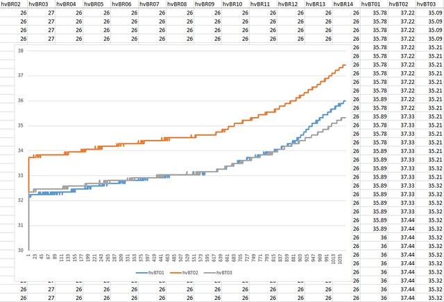

    I just starting having some weird issues pop up, where the battery would seem to drain very low as well as seem to drain fast and charge fast at times. In the 7 years (and only 45K miles) that I've owned it, I have never had all of the charge bars filled up, but now on occasion, all of them will fill. Lately, the engine will rev high, like the CVT is gearing very high (or is it low?), especially when first starting out (engine cold).
    On Friday, I had a distinct lack of power at some points. The HV compartment fan ran very fast and the car would not use EV power even when going very slow (engine kept kicking in). Thinking that I was having a battery problem, I got the ScanTool SX and used PriiDash and checked the battery levels (on Sunday and this morning), and they all look great (within hundredths of each other). The inverter temps don't look out of place.

    It is certainly possible that your car's traction battery is weakening. No DTC would be logged if the 28 modules are losing capacity evenly.

    If you have visibility to traction battery temperature readings from the three sensors, see if the readings are reasonably even.

    I've charted the hvTB0x figures. Not sure what reasonable would be for these.
    hvBTxx
    by Keith H., on Flickr

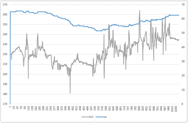

    I find this a bit troubling, since it doesn't seem physically possible, the total voltage (also seen in the individual voltages) spike and drop at rather quick intervals:
    hvV-soc

    Your Prius can momentarily pull/source 100 (130 in later Gen2 Prii) amp currents from/to the HV battery. If the individual module pairs have about 20 milliohms of series resistance, then 14 module pairs in series will total about 0.25 ohms so at 100 amps the voltage drop/increase will be 25 volts which is in line with your readings.

    Both T and V graphs seem OK. I heard that occasionally the battery system re-calibrates itself and appears weird. Could this be it? As mentioned in the other post try to collect data with plenty of acceleration and deceleration to compare the blocks like in this thread:
