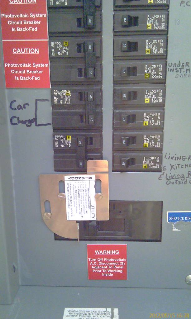

    good eye - sort of ..... it's 2 of 'em. Each rated at 4kW's. And if you're curious about the 240v twist lock box to the right - that's used to back feed the main service panel - once you throw the interlock switch which can't be thrown until the main disconnects from the grid.
    Here's an older picture before switching the car charger wiring and breaker which was only 40 amp at the time - plenty big for the old AV setup.
    You can see that plate slides, and the backfeed breaker can't be active until the main is shut down, disconnecting from the grid.

    ^ sweet!
    You are living the life my friend!!
    I have the same interlock for the generator connection on my main panel. Impossible to connect the backup power unless the main disconnect is off. Simple but safe (and passed inspection w/flying colors).
