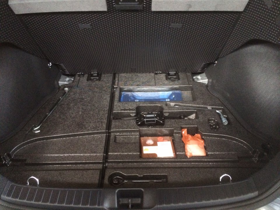

  11. greenmonster01
    Apr 15, 2015
    106
    79
    Southeastern MA
    What's in the blue (static?) bag? On my Eco the rectangular cutout was empty. Is there supposed to be and OEM item there?
  12. Dorkytom
    Dorkytom New Member
    Oct 25, 2016
    Orange county, ca
    It looks like the blue bag contains the front license plate bracket.
  13. greenmonster01
    Apr 15, 2015
    106
    79
    Southeastern MA
    I think I figured in out...I beleive that spot is for the bag for the cargo cover.
    4GP2ECOBP likes this.
