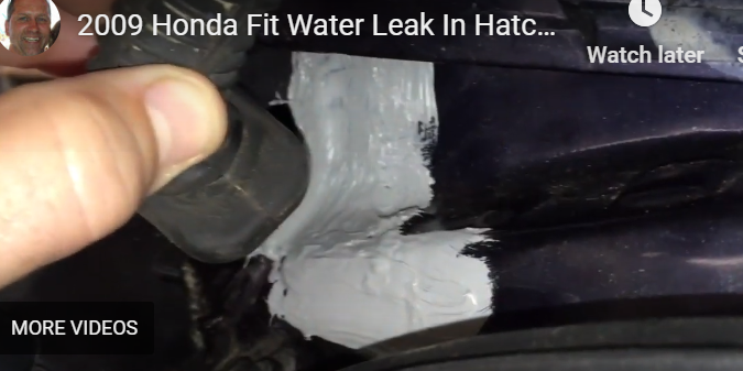

    I checked where the tire is at and i found patches of this, could this have anything to do with it? It's harden though, not like soft in the picture What is it?
    Raytheeagle likes this.

    Here’s a pic from the outside of the rear wheel well on our 2010:
    B6DA5A8C-43BE-4900-9E99-F6EE416B3491.jpeg 543C5991-BA8A-422C-85F8-88C6E59E29E0.jpeg
    Look for gaps or cracks there.
    Maybe something had been hit as road debris along the way and you have your water intrusion point.

    Hey! So i went and checked and they don't look like yours, mine seem to have cracks in them? Could that be the cause? I am so confused because when i was going through the car wash, it would have like foamy water (soap water) in the bottom of the front seat too, so did the water travel that far from the rear to the front? [​IMG] I took a few pictures, let see what your take is on it.

    Seeing that and having water in the cabin on the floor, I’d take the interior apart and examine the inside of those surfaces.

    Water can get into the back of the Gen 3 through the tail light mounting area. There are body seams behind the lamps, so either they aren't sealed correctly or the seals between the lamps and the body may be leaking. It could be something as simple as loose nuts holding the lamps onto the body.
