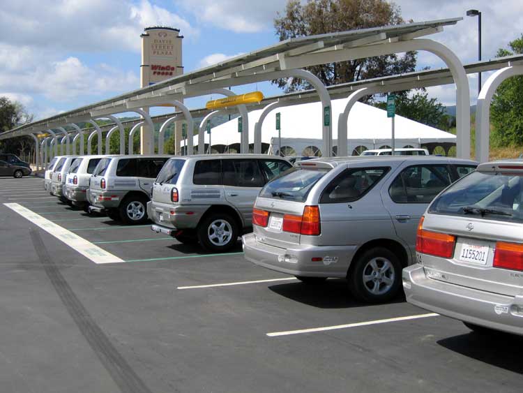

    I'm quite aware. I've driven a couple of the Li Altras. And maybe this is mentioned in the Wikipedia article... and maybe not (just checked - it isn't): The Altima had the single worst battery track record of any of the EVs of the 90's. Serious range degredation before the first year was up. Few of them made it through more than few years before the range was useless. I don't say this to dump on Nissan at all. I love what they're doing with the LEAF. I love that they're making their own batteries. I seriously want them to succeed. I've just experienced some stuff that not everybody is aware of.
    Ah, here we go. Here's a shot with two Altras parked next to my Rav many years ago. My Rav is still being driving daily... the Altras stopped working long ago (oh, and they weren't quick charged!)
