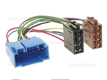

    Did you use the same plug that goes into the actual radio like this? (This is for JVC, so other brands might look differently)
    Or did you plug into the loom of 10cm to two plugs like below? (This is for Honda, so the blue plug would look differently)
    Reason for asking is because one common issue in carstereo's is the yellow and red wiring and the differences between some brands. Mostly this only causes the radio to not remember its settings when reversed, but I have seen it causing other (not always logical) issues that were solved by swapping them around. In the first pic I posted, you would see bullit-connectors so yellow and red can both go to yellow, OR both can go to red OR red can go to yellow and yellow to red, OR yellow-to-yellow and red-to-red.
