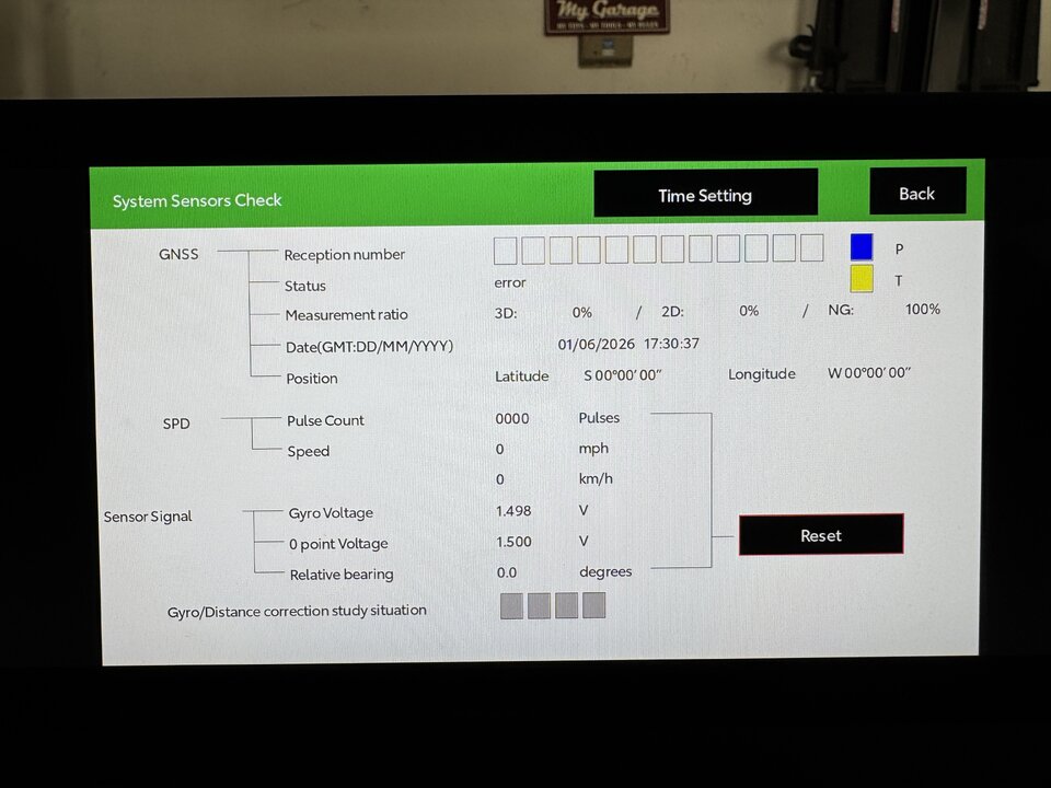

    @lohikaarme , I don't know if you saw my question earlier, but do you have ALL the wires removed from the DCM? I'm curious why your compass works and mine doesn't. Thanks.,
  5. lohikaarme
    lohikaarme Active Member
    Jul 8, 2008
    371
    361
    OH
    2024 Prius
    Limited AWD-e
    Yes I have all wires unplugged except for the WGB cables BUT those three cables go to a singular white plug which I have unplugged so the DCM is 100% disconnected from the car.
    Edit: While I doubt it will have any impact, in order to totally rule everything out the last remaining test is to see if once I get the harness and plug it, will it suddenly impact the compass. The harness seems like it is the only current difference between our car setups.

  6. VelvetFoot
    VelvetFoot Senior Member
    Sep 17, 2025
    1,408
    545
    New York State
    2026 Prius
    Thanks much. I'd ask to see what you get as far as lat/lon/date/time , etc, with the five swipe thing, but it's a big ask. :)

    I dont know how to pull up those screens
  8. VelvetFoot
    Sep 17, 2025
    1,408
    545
    New York State
    2026 Prius
    Going to try "diagnostic mode", posted by @KMO . Probably is just for infotainment.
    Quote:
    Haven't tried it, but procedure from the EU service manuals is:
    1. Ensure that the vehicle is stopped.
    2. Turn the ignition switch to ON.
    3. Turn off the audio of the radio and display receiver assembly.
    4. Turn off the screen from the settings screen.
    5. Perform the "Flick from left to right" operation five times on the multi-display shown in the figure. [Figure just shows a long swipe]
      1. Tip: Performing flick operations may cause messages, etc. to appear on the screen, but disregard these and continue performing the flick operations.
    6. Flick the multi-display 5 times from right to left as shown in the illustration.
      1. Tip: Make sure to complete the operation within 15 seconds of performing the initial flick from left to right.
    7. When diagnosis starts, the service menu screen is displayed.
    Tip: If diagnosis does not start due to a failed operation, turn the display on then off and perform the procedure from the start. (Only turning the audio of the radio and display receiver assembly from off to on is not a valid method)

  11. VelvetFoot
    Sep 17, 2025
    1,408
    545
    New York State
    2026 Prius
    I disconnected the 12v terminal for 15 minutes. Lost date and time settings. I'll turn off my phone and go for a drive later. I can see it getting the time (and no date) and no location from Sirius/XM.
  12. lohikaarme
    Jul 8, 2008
    371
    361
    OH
    2024 Prius
    Limited AWD-e
    I did not pull the fuse. I think the car is syncing position via car play

  14. VelvetFoot
    Sep 17, 2025
    1,408
    545
    New York State
    2026 Prius
    I don't think so. I'll keep that screen up and see what I see. Before and after turning the phone (and CarPlay) on.
    edit: It's interesting that your compass is still correct. There might be hope yet for me.
  15. lohikaarme
    Jul 8, 2008
    371
    361
    OH
    2024 Prius
    Limited AWD-e
    I did disconnect from all the toyotaconnect services a few days ago. That seemed to force a reset of all the settings. Maybe that did something in preparation for unplugging the DCM where I was not impacted? Like I wonder if you disconnect the box before disconnecting the digital side it can cause this?

    The AI overlords suggest the compass should not work- but I can absolutely, 100% confirm that the car compass is rotating with the vehicle and is in sync with the compass of the radar detector.

    2026 Prius
    But you're not using the built in navigation. At least not anymore, lol.
    The overlords had me driving in a circle yesterday at a school parking lot.
  19. VelvetFoot
    Sep 17, 2025
    1,408
    545
    New York State
    2026 Prius
    My compass rotates, just doesn't point in the right direction.
    Some kind of initialization must be required, for me.
