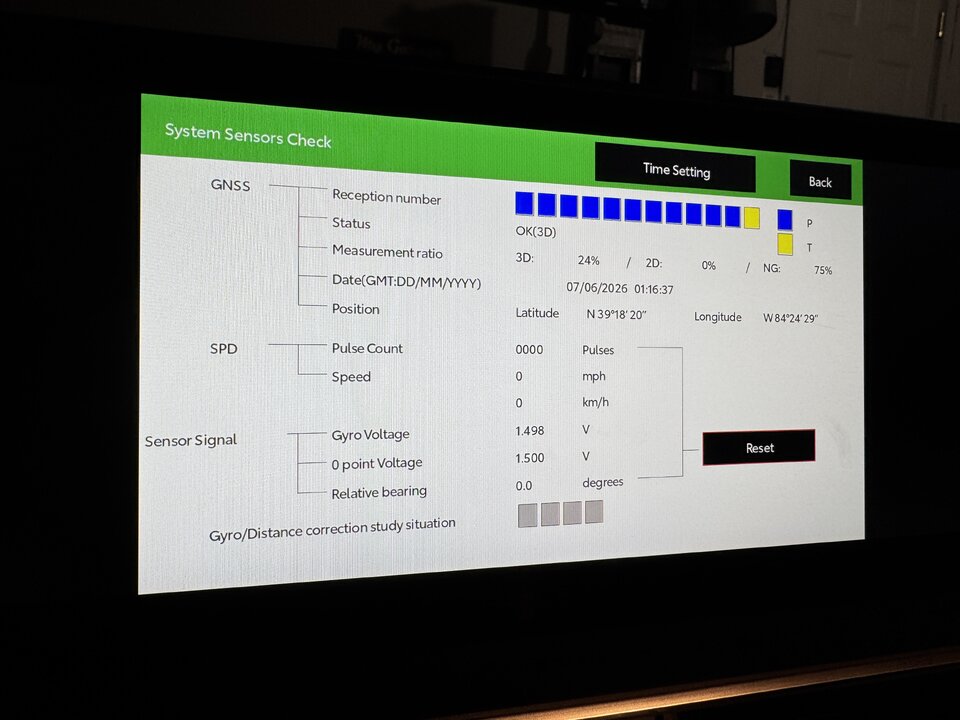

    I think it's getting closer. It seems like it's 90 degrees out of whack.
    I might take another drive after dinner, maybe do some circles counterclockwise this time.
    Driving around with the diagnostic screen on showed:
    -One, maybe two, yellow squares (Date/Time), and then disappear, but enough to snag the date/time and provide it to the dash
    -No blue squares (Position). No Lat/Lon in diagnostic screen. Which is as it should be. :)
    If it is indeed recalibrating itself, it would be nice if it could be sped up.
    What speeds it up probably is the Lat/Lon info from the head unit, which is likely unavailable because there is no hardwired GPS antenna signal getting to the head unit. Although, the head unit can still sporadically pick up the time component without an antenna.
    That's my theory.

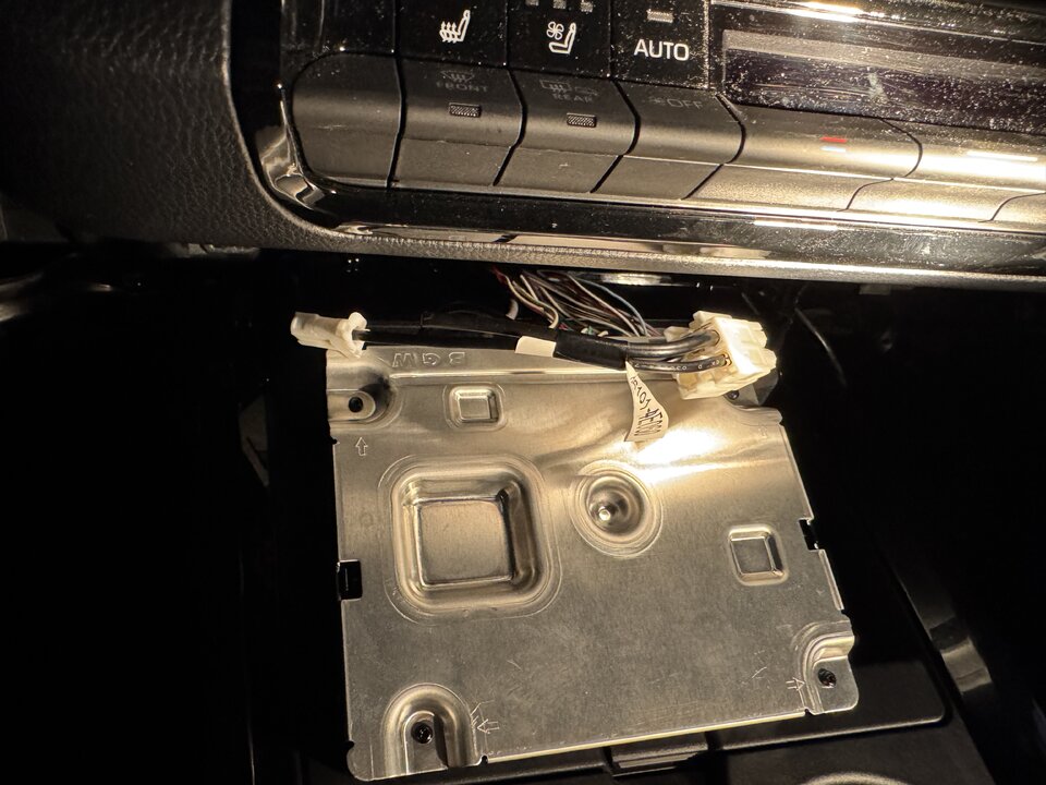

    I am also wondering about that DCM. I have a theory but I do not know how to test it because the whole problem is that you just dont know what the car is transmitting. There are 3 FAKRA antenna connections that connect to the DCM and then out to the white singular connector that goes off somewhere deep into the car (these are coaxial connections so probably to antennas buried somewhere). The connectors are labeled on the DCM WBG and in turn, the colors of the connectors are White, Blue and Gray.
    Because I cannot leave well-enough alone, I decided to mess around some more. The rigged DCM on the center console
    Through some trial and error I isolated the GRAY FAKRA cable to be what is interfacing with the GNSS.
    The setup is to have only the gray FAKRA cable connected to the DCM, leave the white and blue FAKRA cables disconnected. The black square plug, white square plug and long flat gray plug are also connected to the DCM. The 3 FAKRA cables come together into the singular white connector (part number 86101-4E060). and that connector I have plugged into the antenna connectors (but only the gray one is making it through the pigtail to the DCM).
    So now I am wondering if the gray FAKRA is exclusively to receive GNSS data and if the white and blue cables are to wifi\cellular antenna and if disabling the car phoning home is only a matter of disconnecting the white and blue cables.
    Anyone have any thoughts on this? I cannot find any documentation on the connections. If the GNSS antenna is not able to transmit telemetry then this is way grogu. This is the way.
