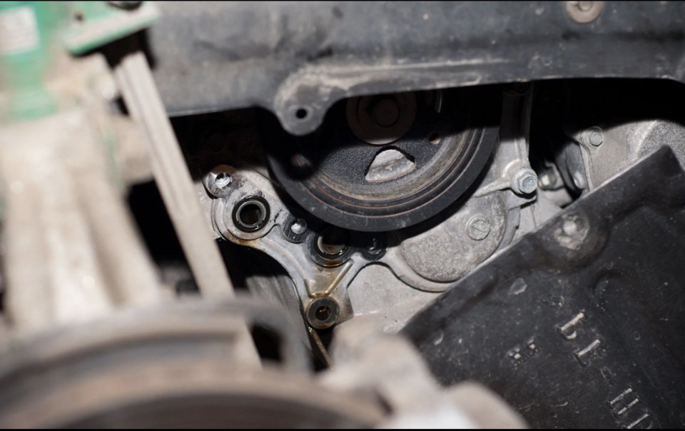

    in the gasket master video, they clearly are in a piece that is an extension of the short block. I checked the oil filter housing and didnt recall seeing anything there either.

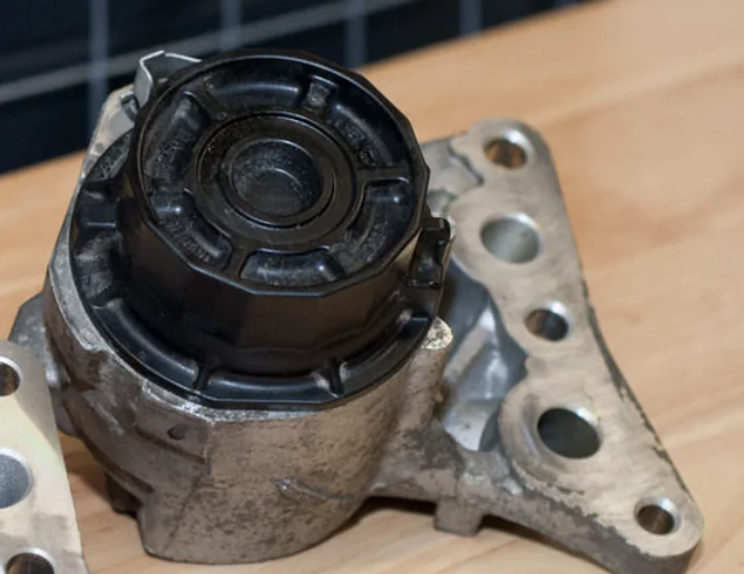

    Oil Filter bracket and orings

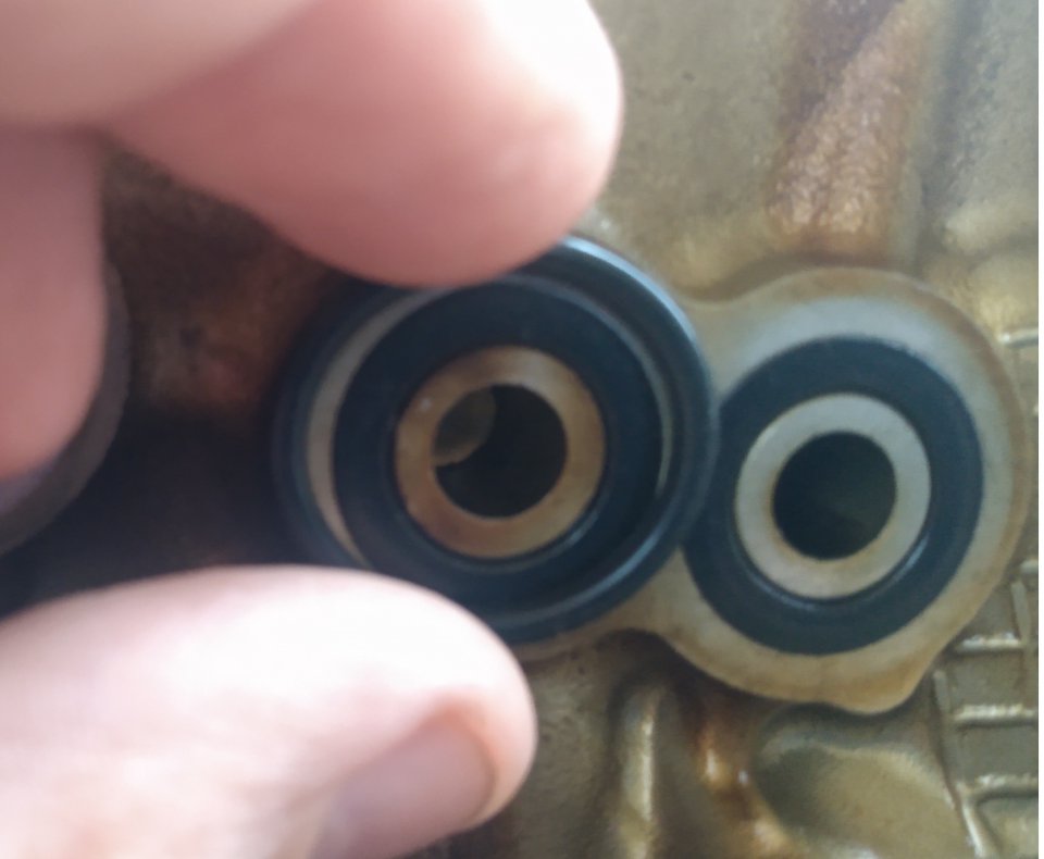

    do these rings sit on the block and i will have to glue them or something? Because in the picture I posted there clearly is no grooves for the rings to be inserted into.
    Are the rings/grooves on on timing chain cover?
  4. ASRDogman
    ASRDogman Senior Member
    May 29, 2018
    7,569
    3,903
    When you put the timing cover on, you will see the grooves on the timing cover.
    Which is what I meant, but said on the housing. I guess I was thrown off by the picture
    with the timing cover off.... sorry...
    Look on the timing cover... like in the photo above.
    An2TheTwan likes this.

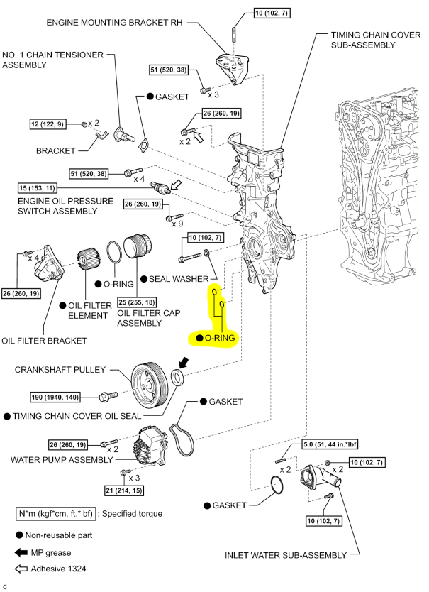

    For clarity, this is where the o-rings go:

  7. Mendel Leisk
    60,187
    41,398
    I replaced the oil filter assembly on our 2010 (converting to spin-on style oil filter): it goes on top of the timing chain cover, which has oil passage holes with recesses for those O-rings.

    My next question:
    I went to a Toyota dealership and asked for assistance finding these O-rings. Although the representative I worked with was pleasant, I felt he was unsure about the parts I needed.
    The next o-ring in question is under the valve cover. The new one I ordered (right) is smaller than the original (left). Is it common for these to swell up/increase in size over time? This looks pretty significant size difference.
    Link to video 32:43 seconds
    (also, the other o-ring I ordered which looks like a ghost/surprise face/has 3 circle - this was roughly the same size as the original.

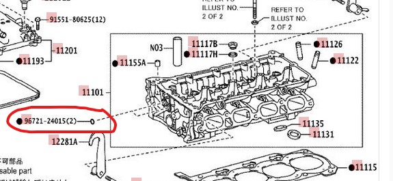

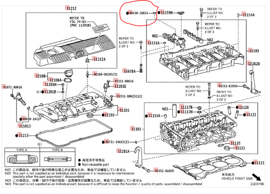

    Not 100% sure, but from the so-so pic on this page:
    CYLINDER HEAD. 2011 Toyota Prius Hatchback | Toyota
    Second pic on that page, you need to select it, and enlarge it. Screen-grab:
    It might be:
    90430-10024
    FWIW, Toyota makes a gasket kit, includes head gasket and all these. Part number for the kit is:
    04111-37315
    found in attached.

    My next question:
    •Refer to video
    about 23:27 seconds in:
    •I need three o-rings, it looks two on the head and one on the short block.
    •Per the photo Mendel posted, are these item# 96721-24015 (Ring, O , For Oil Strainer) ???

    Does anyone have the part number the these o-rings? The ones on/near the oil filter housing:
  15. Mr. F
    Mr. F Active Member
    Sep 21, 2020
    388
    257
    Washington
