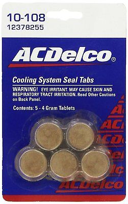

    Tomorrow I plan on taking a desk drive, adding coolant and the Bars Leak/AC Delco coolant sealing tabs, seems like other people had luck using these.

    Don't put the sealers in.... not good for the radiator or heater core. And it WILL block
    coolant ports.
    You need to drive it to get rid of any coolant in the exhaust. It gets a lot hotter when driving.
    #113 ASRDogman, Nov 3, 2022
  14. rjparker
    rjparker Tu Humilde Sirviente
    Jun 6, 2008
    10,130
    6,291
    Texas Hill Country
    Absolutely don't use a sealer now! Drive it! Smoke at first is normal.

    Holding off on adding cooling system sealant tabs.

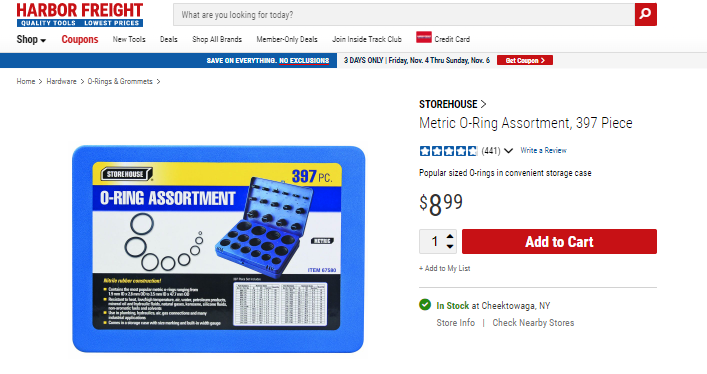

    O-Ring Assortment Pack - 397 Piece Metric O-Ring Assortment
    ^ I wanted to post this O-Ring kit I used from Harbor Freight. It was a pain to find all the O-Rings when doing a head gasket. Also much more expensive if you order them individually. I called Gasket Masters and they suggested this kit. It's less than ten dollars and will give you about 60-70% of the O-Rings needs when doing a Gen 3 Head Gasket job. Plus you will have plenty left over.
    I also wanted to thank everybody who contributed in this thread and for this board in general. The depth of knowledge Prius Chat users have is astonishing. I would not have been able to do this without this resource. I hope this thread will help somebody in the future.
