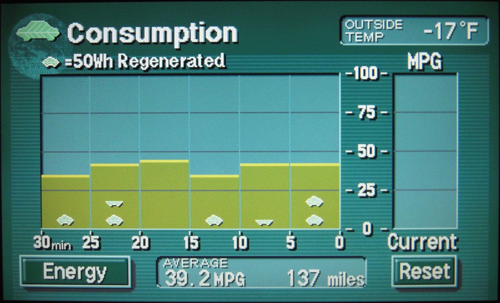

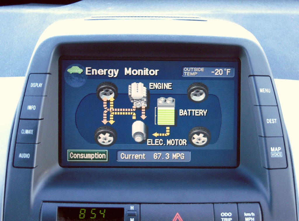

    Do you have the average mpg for that trip instead of the instantaneous? I could probably get 99.9 on that screen when its on battery only at any temperature, but it's not a good measure over time.
    I would also note that the battery shows green and not at the optimal SOC so the car is probably pushing more electrical energy to the drivetrain resulting in a higher fuel economy.

    It was that extreme nasty winter cold 2 days in a row. I went nuts with the camera trying to document as much as a could. There are 42 photos available from those commutes. Starting on this webpage.
    This is what I have for data available from that driving...

    WTH! I didn't even know that the display went that low.
    -40C, BTW, is the lower limit for the temperature range automotive semiconductor parts are specified to. Lower than that and you might experience some weird ECU behaviour (on any car, not just the Prius)

    Good to know. I was probably out there for about an hour... The parkade is set to about 18-20°C so there was quick freezing of metal parts the moment I left the parkade!
    According to the manual, it only goes down to -30°C... we hit -30°C a few times a year (fortunately, we didn't hit -40°C this year)
