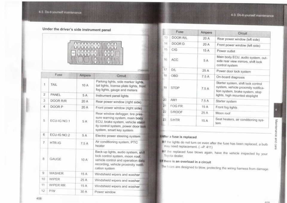

    HI there,
    I am looking for a constant power fuse to tap into.I was told to say away from oringal fuses for the Ecu, sensors and digital displays.
    Does anyone know which fuse i that has constant power and need a fuse for acc as well.
    Any suggestions would great
    Heres a diagram of the cabin fuse box
    Thanks View attachment 56705

    What are you trying to do with this? You could hook straight to the 12v battery if you weren't worried about a dead battery depending on what you're trying to power..

    Ya I only have one fuse that is only hot when I turn the car in and off when the car is off . Now I have already connected that to the monitor for my rear camera . Now I need another fuse that only is only hot when he car is on . I need this for a dummy alarm which has the red positive in a constant fuse which I will use the front fogs and need the negative black to a fuse that is only hot when the car is on . Now some suggested that since the led dummy alarm uses like less than 3 amps i could connect the negative black from the dummy alarm to my positive red in my cigerette socket which only comes in when the car is on any suggestions would be great

    I had a "fake" alarm once upon a time in a 81 Datsun 210 SL. Used a blinking red LED from Radio Shack. Connected the + of the LED to a constant battery 12V+ connection. I used a multimeter to find an ignition source in the fuse box that happens to be grounded when the ignition is not on. When the ignition switch is on, both + and - of the LED gets +12V, so the LED is off. Get a multimeter and start probing with the car on and off. The LED draws negligible current when on. In the 210, the LED outlived the car.

    By connecting the LED negative to the positive camera monitor feed wire, you may end up powering up your camera monitor (since the negative lead is grounded). You need to find a fuse location that is +12V when the car is on and ground when it is off.

    yes i found a fuse (coming from my front fogs ) i used a current tester and that was hot when the car was off and on.
    so i connecting the fake alarm postive to that and the black to acc but there i only one acc that i could detect in the fuse box the other has to do with ecu , and i was told not to fuse tap anything device to a fuse that controls the ecu, computer , sensor or digital displays.

    I don't think the blinking LED will negatively impact anything. What about the fuse to the radio or the cigarette lighter 12v?

    Thanks for the replay I have a device hooked up the cig socket already and that is the only acc I have the other acc controls te ecu and I don't want to fuse tap that

    Here's an idea that doesn't help if you want ACC, but works well if you want something powered only when the car is running (READY). The basic idea is like one of those battery protectors that let you run stuff off the battery until the voltage drops below 11 or so, then shuts off so you don't fully drain the battery. You just change the voltage threshold so it's up slightly above 13. That's above the battery voltage when the car's off, but the nice regulated 13.8 from the DC-DC converter will turn it on when the car's READY. What's nice is you can just wire it right in at the battery in the back of the car, and you don't need to find and tap into some ig-switched circuit to control it on and off.
    The one I built for my Gen 1 is here - mounting location etc. would be different for a c, but the operation should be the same.
    One thing I've thought about adding to mine is a switchable threshold: using a switch and a second zener I could have the option of a lower cutout voltage, like a regular battery protector, for any time I actually wanted to keep some load running for a while with the car off.
