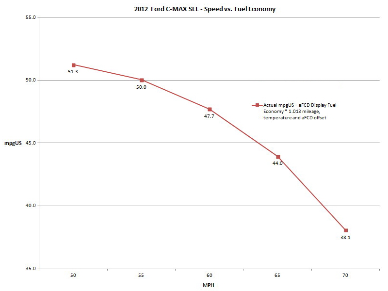

    Thanks, I was sure wayne would put it through its paces and give us the real mpg scoop. It doesn't seem nearly as dire as CR made it out to be, but does greatly under achieve at fast highway speeds. Ford needs to market this differently and then they have a hit on their hands.
