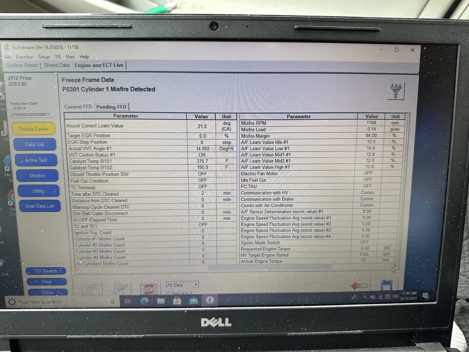

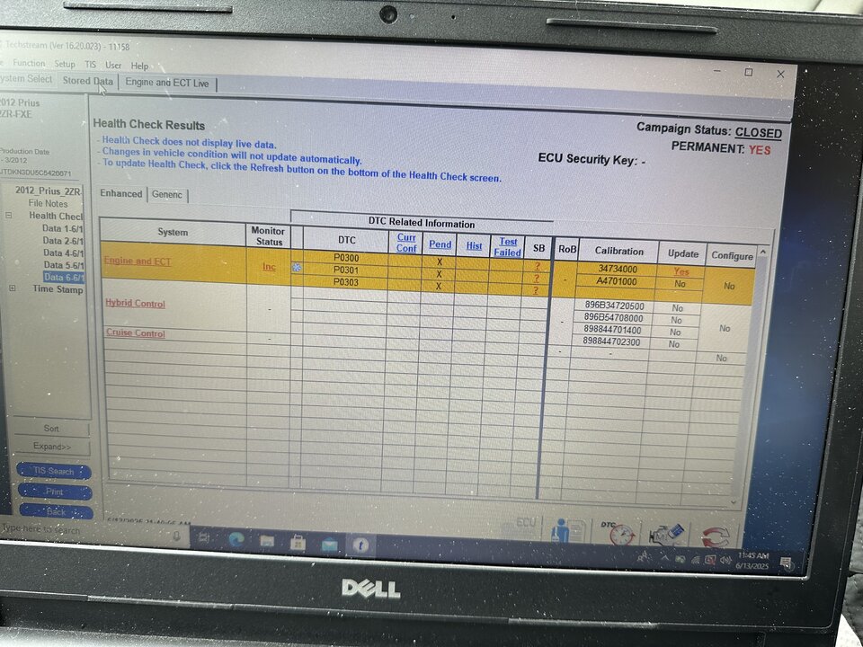

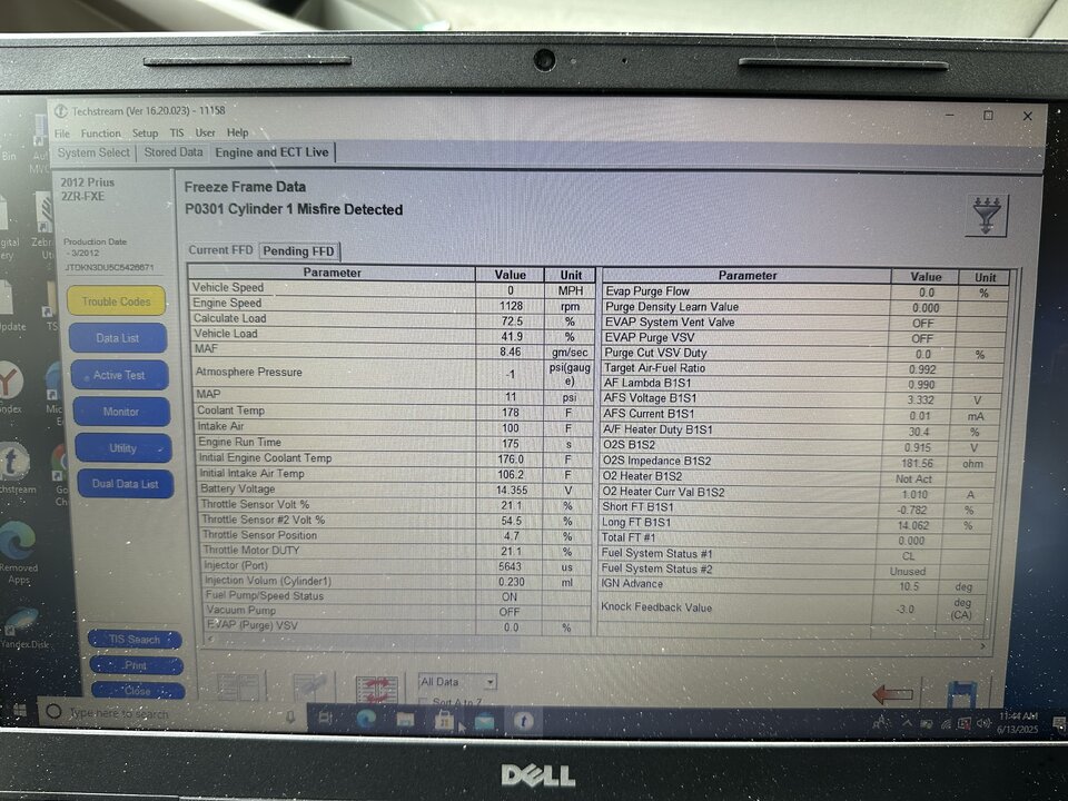

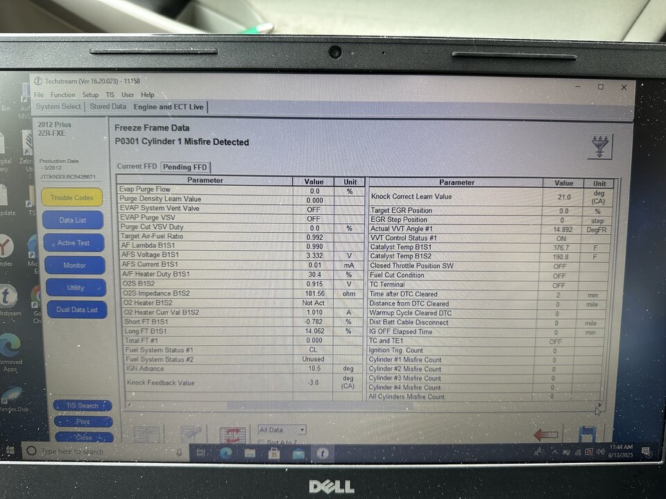

    After reassembling everything, I started the car yesterday. While the rattle is now less severe, it’s still present. More importantly, the car now has very little power and shakes during acceleration. I pulled the codes again and it’s still showing a misfire.
    I’m at a loss for what to try next. Any help or guidance would be greatly appreciated.

    Are the misfires occurring in just one or two of the cylinders?
    If so, swap the coils around and see if the symptoms change.

    I got the car running normally again. After testing the ignition coils, I found that two were faulty. I replaced all four with new OEM coils, and everything is working smoothly now. Thanks to everyone who took the time to respond—I really appreciate the help!
