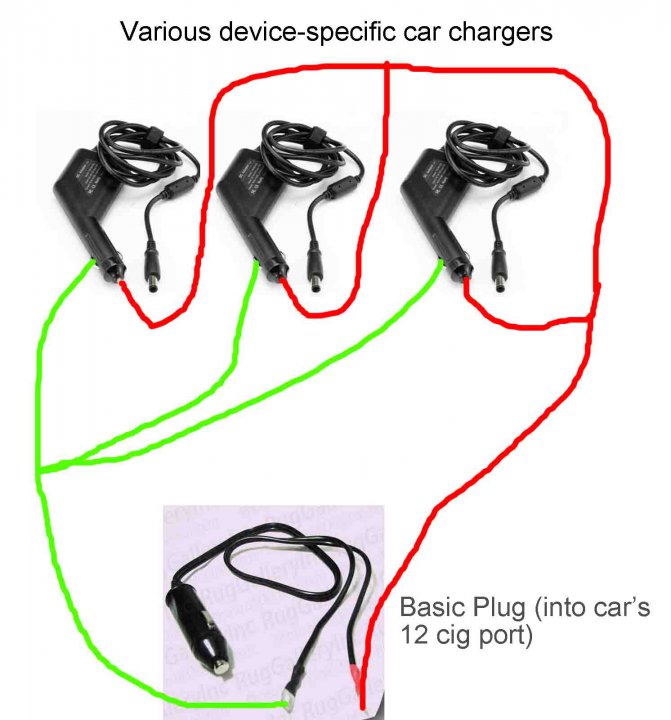

    I am tired of the cig lighter plugs popping out all the time so I would like to convert my car's 12V cig lighter system to a DC plug connection system to power 5 devices:
    Device 1: Cellphone powered by: micro USB (5 volts I assume). I imagine the cellphone uses 1 AMP, 5V
    Device 2: Latitude Laptop Currently powered by: Car Power Charger Adapter for Dell Latitude D400 D505 D510 D631 E5400 E6410 | eBay , 19.5V, 4.62 Amps
    Device 3: Mini Hi Fi Audio Stereo Amplifier 12V Amp for Motorcycle Boat Home Car US Stock | eBay , Currently powered by: DC12V Car Cigarette Lighter Socket Auto Power Supply Cord 5.5mm Adapter Charger (it's 12v so no power conversion). 12V, 6A
    Device 4: Currently powered by: CA-570 S, 8.4V 1.5A
    Device 5: RoadMate 1700 powered by: Vehicle Power Adapter , 5V, 1A I think
    Note: the cellphone USB conversion device should one which transfers the power in a way that prevents the ground loop.
    I picked the following parts:
    Power Conversion:
    1. DC DC 10 24V to 5V 1 5A Step Down Isolated Power Supply USB Charging Converters | eBay - $11.99
    2. 60W 5A 4 32V 12V 24V to 1 25 20V 19V Step Up Step Down DC Converter Regulator | eBay - $12.95
    3. No converter necessary, 12V. - $0.00
    4. 1 DC DC Buck Converter Step Down Module LM2596 Power Supply Output 1 23V 30V | eBay - $2.31
    5. New Waterproof DC Converter 12V Step Down to 5V 3A 15W Power Supply Module | eBay - $2.71
    DC plugs:
    1. Some $1.00 micro USB cable. Just connect Red to + and Black to GND, right?
    The rest: do I just get a $5 universal DC plug set? Then I just solder some wires to the plug, back to one side of the power convertors, and solder wires from a disassembled cig lighter plug to the other side of the power convertors?
    Universal Tool Notebook DC Power Adapter Socket Plug Connector New | eBay - $5.39
    10x DC Power Male Jack Connector CCTV Security Camera DC Jack Pigtail 5 5 2 1 Mm | eBay - $5.99
    I already have 50ft of High Voltage Cable 24KV (20KV) for any wiring/soldering I need to do.
    #1 primuspaul, Feb 8, 2015
    bwilson4web likes this.

    I am certain the lighter socket is fused at 15 amps so I don't understand what you mean. The manual says to use a 15A fuse there and that's the fuse that is there. I checked.
    Okay, so based on the responses, I think it would be better to just take the existing 12V cig lighter adapters and just solder wires to the connectors and connect those to a single cig lighter plug and somehow attach that firmly into the cig lighter plug. Or do the soldering and then just wire the entire setup directly to the 12V battery to avoid frying the car's internal 12V wiring system (which probably won't happen unless you do something like put a 20+ amp fuse into the cig lighter fuse port).
    Can I safely just solder all of the side connections together, all of the center spring connections together, and wire each one to one point on a single plug?

    I see what you're saying regarding the wattage. 185/12 = 15.42, which is above the 15A fuse on that line. I can do what I outlined in the uploaded image above, just wire it directly to the 12V battery. I can glue together the cig lighter chargers from the 4 devices by their large plastic enclosures. Then I can solder and insulate (with rubber) the chargers using a piece of wire at the negative side terminals, and with another wire at the positive center point terminals. Then I'll just solder the negative and positive wires to two longer wires and wrap+bolt those onto the 12V in the trunk. I assume this won't damage the car, correct?

    Gluing the enclosures together and soldering to the contacts sounds like a dirty kludge, and won't let you change out devices easily.

    If Toyota puts a 15 amp fuse on a circuit, that means all the wires Toyota supplied in the circuit have been sized to safely handle 15 amps. In case of an overload or short, the fuse will blow before those wires melt or ignite anything.
    If you plug some gizmo of yours into that socket, and the gizmo's wiring cannot safely handle 15 amps, and that wiring becomes damaged/pinched in the seat rail/whatever, the 15 amp fuse might not blow before your wiring melts or ignites something. If you attach anything to a circuit that would not safely handle the maximum that circuit can deliver, it's up to you to supply a smaller fuse that will protect what you have attached. If you look at a lot of cig lighter powered accessories, you'll find there is usually a fuse contained in the lighter plug, small enough to protect the (often very skinny) accessory cord. If you're thinking of cutting off the fused lighter plugs and soldering wires together, including properly-sized fuses becomes your responsibility.
    In other words, you can't only think about how much current the gizmo is intended to draw. Maybe it's only meant to draw half an amp, which means its cord might have really skinny wires that might only be safe for carrying an amp. The cig lighter plug on the end of that cord probably has a 1/2 or 1 amp fuse in it, so the skinny cord will be protected from unsafe currents even if some damage to the wiring or fault in the gizmo makes it draw more current than it was meant to. If you remove that plug and fuse and connect that skinny wiring to a circuit whose only fuse blows at 15 amps, you've asking for trouble.
    You're really asking for trouble if you wire stuff directly to the battery without proper fusing. Nothing will stop that battery (even a dinky Prius battery) from delivering hundreds of amps into that wiring if a fault develops.
    The other reason to be careful about attaching stuff to the battery directly is not so much a fire safety issue, but it could inconvenience you by draining the battery. The Prius battery doesn't store very much energy, so if any of your permanently connected gizmos draw any current while the car is off, you could find the battery drained when you come back. You might want to connect your stuff so it disconnects when the car is off. There's a product, the VCM-06, that's great for that purpose: it can tell when the car is in READY (voltage goes above 13) and turn on, and automatically turn off when the car is turned off.
    The VCM-06 also contains its own, fuseless, self-resetting, current limit to 15 amps. If you are connecting loads with lower safe currents then it's still up to you to supply the smaller fuses they need. If you need to draw more than 15 amps, you can add a relay and use the VCM-06 to control it.
    The link I supplied earlier can give some ideas on how this can be set up.

    The USB adapter is rated at 2.4A per port, the actual current flow will be determined by what you plug into it, including the type of cable. That is just the maximum it can provide. But, as fuzzy1 pointed out, the circuit would be overloaded.
  15. Avi's Advanced Automotive
    Avi's Advanced Automotive Independent hybrid repair shop
    Jun 28, 2012
    776
    363
    This would work in theory. I would be concerned about the springs that push the tips out not having enough tension on them causing a poor connection inside the adapter.

    I'm only concerned about the Toyota wiring. I don't want to have to rip the car apart to replace those wires. My wires are external and easily replaced.
    What I was planning on doing was putting a on/off switch on one of those wires leading directly from the battery. However, I doubt it's necessary since I don't think my electronics can realistically even reach 180 watts (15 amps at 12v). If they ever do, I'll just blow the 15A fuse (happened a while ago after I used a cheap chinese cig lighter socket multiplier which apparently had a short), replace it and disable a device until I have time to wire directly to the 12v.

    Anyway, looks like all the equipment I need is:
    New Auto Car Charger for Canon M32 M31 M30 M300 HF21 S21 S20 S200 S11 CA 570 | eBay
    Car Charger for Magellan Maestro 5310 Roadmate 1700 1700 MU 1700LM GPS Receiver | eBay
    I can just rip apart the plastic housings to avoid the "spring" issues mentioned above and solder those to the positive/negative points on a good cig lighter plug. The total comes in at a few pennies less than the original idea I posted, just under $30.
    So the only issues remaining:
    1. I need a reliably-built cig lighter plug with a 14-15 Amp fuse (or I can buy the fuse separately if necessary) with wires on the other end I can wire to terminals for the rest of my assembly.
    2. There is still the issue with the cellphone ground loop. Can I just get this: DC DC 10 24V to 5V 1 5A Step Down Isolated Power Supply USB Charging Converters | eBay
    and wire that to just the + and GND connectors on a disassembled micro USB wire and the other end to my main cig plug's 12V connector terminals?
  20. ChapmanF
    28,632
    18,958
    ... if the biggest risk of an improperly fused electrical circuit were just maybe having to replace the wire, insurance would be dirt cheap ....
