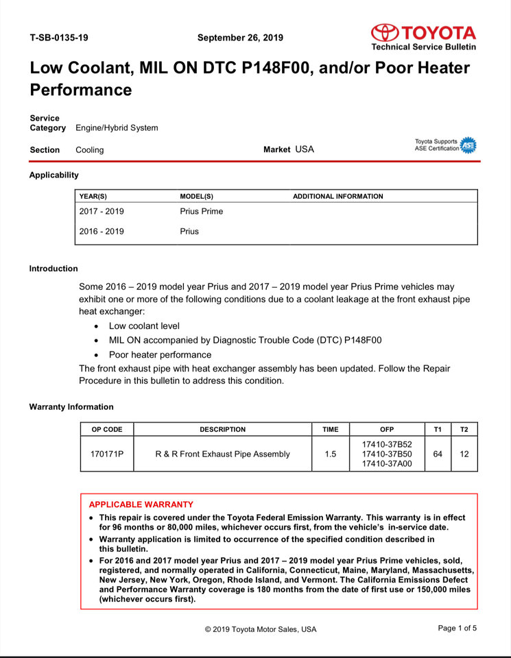

    From what I've read (mostly here) it's due to a defective batch of the Exhaust Heat Recovery components: it has an internal radiator with coolant running through it during warm-up, and it's been leak prone, presumably due to defective welds.
    Later model years I think don't have the problem, though I think it dragged on a while, till Toyota "woke up". To date owners are having problems getting it fixed, due to dealerships, either due to ignorance or avarice, that misdiagnose as head gasket failure, and/or bill owners when Toyota would pay.
    I suppose Toyota's fine with that (Toyota and the dealerships conveniently enable each other), and as well seems to be dragging their feet on production of the (expensive) replacement component, which includes catalytic converter.
    And yeah, it does technically defeat a pollution control when owners do a bypass, and I'm sure both Toyota and the dealership would love to say it voids warranty.

    2016 & 2017 cars seems to be the ones failing. I think the issue was resolved in the 2018 model year.
    You technically aren't allowed to bypass it, because under CARB rules - that's defeating a "smog device component". If they catch you, you'll automatically fail smog and forced to go to a referee station for 'tampering' with a smog device.
    I wouldn't preemptively bypass it, because of what's stated above and denying coolant flow to the heat exchanger will probably hasten it's demise. No coolant to prevent the hot exhaust gases from melting the welded joints.
    Just pop the hood at every fill-up and take a glance at the coolant jar, probably check the oil too. It's a good habit to get into and will probably save you money in the long run - you'll catch potential issues early.

    I'm another Gen 4 owner (in UK) with the same issue (slow coolant leak, no other problems). I took the car to Toyota service centre who did diagnostics (£180) and reported failed defective heat exchanger, leaking coolant into exhaust which burns off - smell and smoke (which I had not noticed). Booked in for replacement at further £1617. Car is 2016 and covered 135k (trouble free - except TPMS) miles, last Toyota service was 100k since then used independents so no warranty. Any UK owners had any luck with getting Toyota to pay a contribution?

    I don't know how the emissions standards and laws are structured in the UK; but it might be worth researching. Federal laws on this side of the pond is 8 years or 100K miles on all smog equipment. Some states has tighter standards, which has saved consumers a lot of money on these mandated smog devices. Check you year's make and model warranty booklet; it might be online. Also check for TSB, we had one here - that will sometimes extend the warranty on that particular problem.

    Just providing a Canadian data point: our 2017 Prius with ~127,XXXkm had this happen last week, and it was fixed under our 8 year emissions warranty, and the updated part was available in the Toronto PDC for next day delivery to our dealer.
