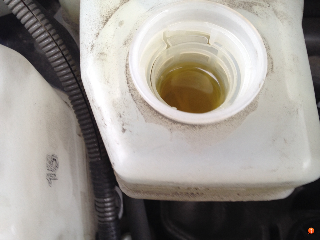

    I can't imagine the friend making that mistake. He works on his own cars. The reservoir for the brake fluid is very small compared to a coolant reservoir. And it's located way up by the windshield cowl, very far away from the radiator.
    It is more likely he topped off the coolant with green coolant in the reservoir, the one he can't see through clearly. Otherwise he would know it's pink and not green.
    I suggest the OP flush his coolant. I would check the brakes but highly doubt that was mixed in.

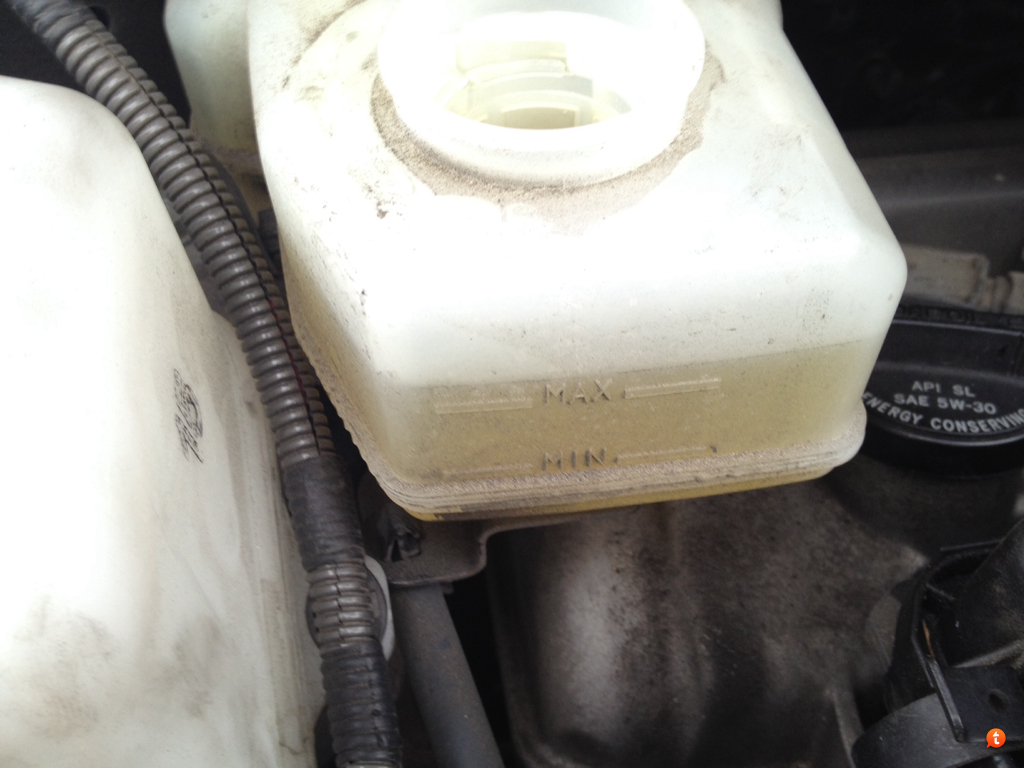

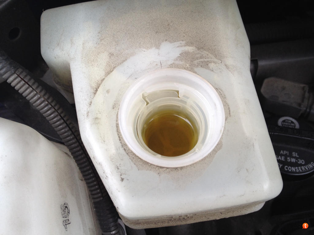

  8. r619
    r619 Junior Member
    Nov 17, 2013
    38
    Atlanta, Georgia
    [​IMG][​IMG][​IMG]

  9. JC91006
    JC91006 Senior Member
    Nov 10, 2013
    16,936
    8,647
    Your brake fluid is fine, it's clean and clear. The worse your friend could have done is mix green coolant with your pink in the coolant reservoir. The rattle noise you are hearing is most likely from the brake accumulator pump.
    Confirm with your friend to see if he indeed added coolant to your car. If he did and it's the green kind, go and have your coolant flushed and changed.

  11. Patrick Wong
    Patrick Wong DIY Enthusiast
    Mar 8, 2008
    18,210
    6,517
    Green Valley, AZ
    Your photos of the brake fluid reservoir look pretty good.
    However, your car needs major service, regardless. As part of that service, I strongly suggest you have the brake fluid flushed because that particular service doesn't cost very much (should be less than $100) and this will eliminate any lingering doubt that you may have about the integrity of the fluid.
    You really do not want to have introduced any foreign liquid, especially one that is water-based, into the brake fluid. That will result in brake components corrosion and in addition will severely impact the performance of the friction braking system because the boiling temperature of the brake fluid will be reduced. You do not want the brake fluid to boil because if the fluid changes to gas at the front disc calipers, you will lose braking effectiveness.
    Since the Prius normally relies heavily upon regen braking during normal driving, impairment of the friction braking system may not be immediately obvious to the driver.
