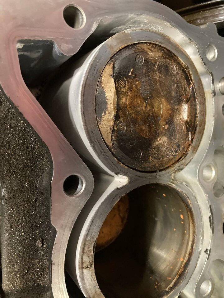

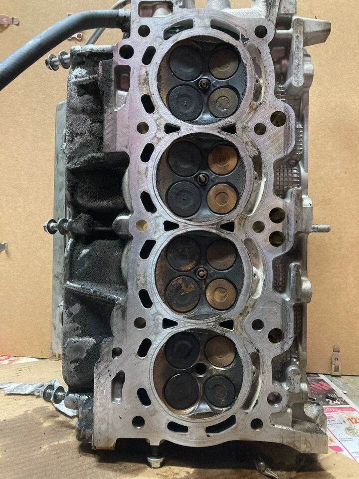

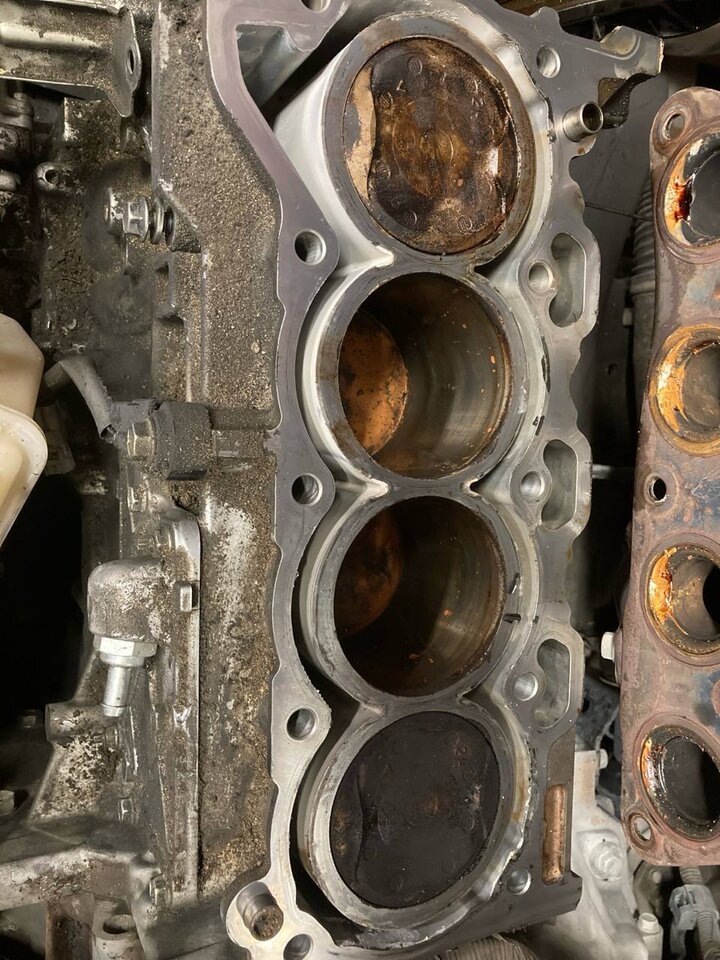

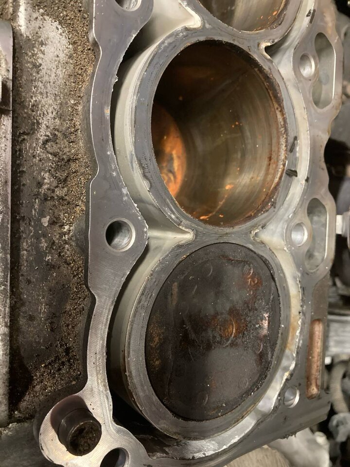

    The head gasket (see attached images) does not appear to me to be causing all the coolant in the oil but I don't know.

    Rust on the top of your pistons is NEVER a good sign. Neither is the clogged water jackets on that gasket, in the block. Someone dumped 'stop leak' into it?
    IMHO; I'd look for another car. Even if your able to fix this with a head gasket, there's a good chance something is bent and you'll have cooling system issues in the summer months. Mainly due to the stop leak blocking your coolant system and making your heat exhangers inefficient. Coolant in the intake could be a leak in the EGR cooler. Other issues may also be present; cracked and/or warped head and/or block; since the car has been running w/o coolant. When you blew the heater hose, you pumped all the coolant out of your engine and radiator. It has an electronic water pump, so as soon as your key-on; it fires up that pump.

    The head gasket does have coolant to cylinder compromise on all but cylinder 4. That's not a happy engine.

    Can you explain the discoloration in the block coolant, #1-2 vs #3-4, counting from top to bottom. Pictures 2-4. There was definitely something going on for that discoloration and build-up to take place on just those two cylinders. Looks like calcium deposits, water instead of antifreeze; but weird thing is that it didn't effect #3-4. Those two running hotter than the later or is it just the angle of the picture?

    Yes, you are correct, cylinder 1 and 2 are a lot whiter than 3 and 4. I did add bottled water and tap water in it to drive it home when the first incident happened. It is not coming off when scratching it, looks like paint; I have no idea what it is, could be calcium?

    That's another reason, why I wouldn't waste my time and money patching-up that motor. That stuff is chemically bonded to the metal. At your age and if you have money for parts; it could be a good learning experience for ya... Just know that you may be flushing all that time and money away - but tuition isn't cheap either.This would be the school of "hard knocks".
    FWIW; I see head gasket deformations in the 1-2 o'clock position on #1-2 and 4-5 o'clock position on #3. Possible, another break point in the 5 o'clock position on #1. I can't tell on #4, but no rust on that piston.
