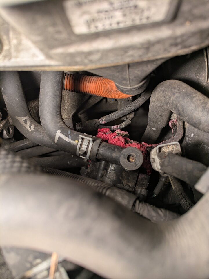

    A couple of weeks ago error code P1151 popped up. This code indicates an issue with the Coolant Heat Storage (CHS) system. Anyway, I then noticed that there was almost no coolant in my radiator reservoir so I filled that up and reset the code. The code has not resurfaced.

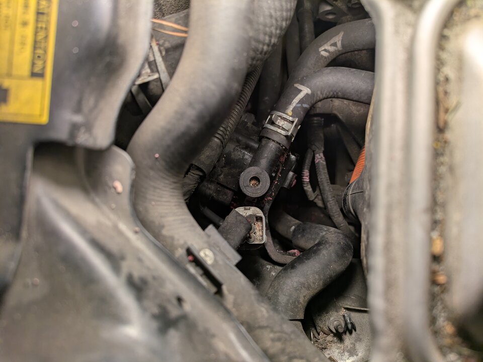

    Yesterday, I checked the radiator reservoir again and it was just below the low mark. I again filled it up and then on further examination of the engine bay, I noticed pink residue from coolant on what looks like a pump - initially I thought it might be the inverter water pump, but it appears to be the 3 way coolant control valve. I started the car up and drove it around the block - I couldn't see any coolant actively leaking from this valve or the connecting hoses. I still haven't had any codes return.
    Does anyone have any tips for replacing this 3 way valve. How about for bleeding afterwards - can I assume that this valve is only connected to the engine coolant loop and not the inverter loop?
    I'm also thinking of purchasing the Autel AP200 to do the bleeding procedure afterwards - anyone have success using this tool?
    I've attached pics taken from the top view, facing the front of the car: the pump is in front/below the right side of the inverter. Additional pics taken after cleaning off the reservoir as well as a pic from under the car.

    That is probably where it is leaking, but since you didn't actually see any fluid there, you might want to find out for sure before replacing it. That could be from an old leak. Knock off the bigger chunks and then wash off the rest. If it comes back, now you know for sure.

    Sounds like it is not leaking. If it was really pouring out it might also fling coolant in the plane of the drive belt, pool coolant on the plastic shields on the bottom of the engine compartment, or puddle under the car. All of those would have been pretty obvious.

    It's definitely leaking from the coolant control valve - I can see coolant beading on the valve and there are some drips that accumulated on the plastic guards below.
    My one question remaining is that the fault code that originally popped up is specifically for the Coolant Heat Storage tank P1151... although one of the coolant control valve outlet pipes leads to the CHS tank, all reports of the 3 way coolant valve failure reference a different fault code (none have mentioned P1151). Is it possible (likely/unlikely) that some failure of the CHS system caused the 3 way coolant valve to fail. Or is it more likely that the coolant valve failure resulted in the P1151 code? I cannot see any leakage coming from the CHS tank - but I have limited access to that area.

    If the three way valve is leaking you need to replace it no matter what codes you see. With the caveat that you should attempt to figure out if the fluid is coming out of the valve itself or from a deteriorating hose or clamp. You may already know which as you have seen it, but we have not.
