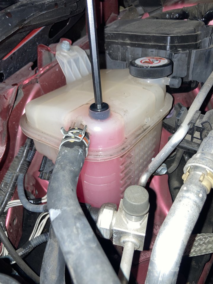

    Part of what's making this interesting is that not every Prius generation has an "overflow bottle".
    Gen 1 and Gen 2 have overflow bottles. Gen 3 has a "degas bottle", and so does Prius v. But Prius c still has an overflow bottle (I think). Gen 4 can come with either an overflow bottle (PNC 16470) or a degas bottle (164A2).
    If the bottle has just one hose, going to a radiator filler neck just below the cap, it is an overflow bottle. It is a stagnant backwater of coolant, and when the engine heats up and coolant escapes under the radiator cap, it ends up in the bottle. When the engine cools and the coolant contracts, it gets sucked back in.
    If the bottle has two or more hoses and you see coolant flowing right through it while the engine is running, it's a degas bottle. It is not a stagnant backwater but a regular part of the flowing coolant path, and the hoses are arranged so that any gas bubbles in the cooling system naturally get delivered to it (hence the "degas" in the name).
    The Gen 4 degas bottles have the extra bleed cock, as shown in the photo above. The Gen 3 degas bottles don't; they have enough headspace for the bubbles you'd normally get while burping the system, and any extra gas just escapes the next time you take the cap off.
    The Gen 4s that come with overflow bottles still seem to retain some aspects of the degas design; their "radiator cap" is really on a separate "filler neck" right next to the bottle, and there is an extra hose running to that, very much like the one from the system's high points in a degas-bottle arrangement. So it doesn't seem like the engineers simply time-warped back to the days of overflow bottles, but that they came up with some clever other way to do degassing.
