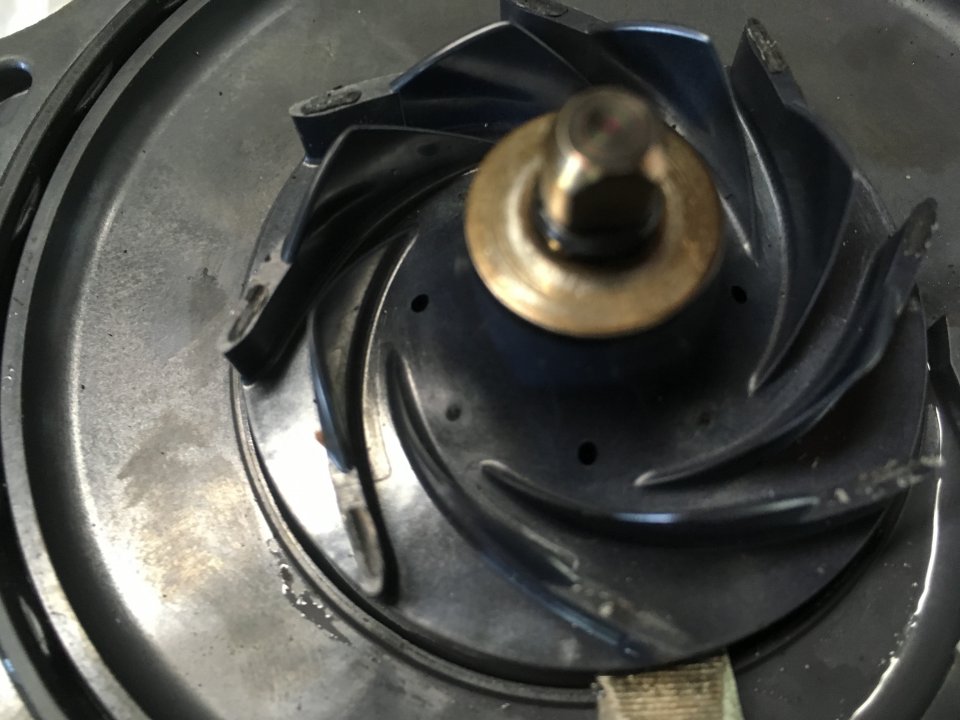

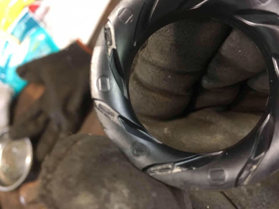

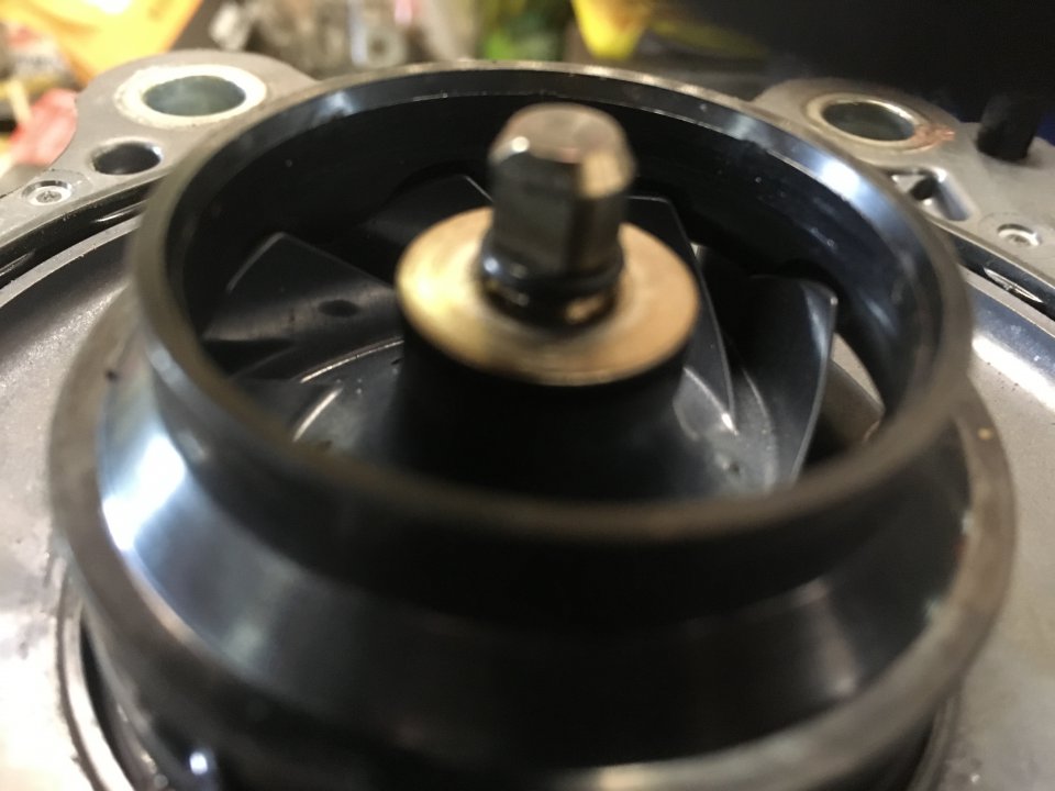

    I took the pump apart and the impeller vanes are ok. It's the off white plastic coating around the magnet that failed in three places (two on one side, one on the other) The split/failure is about 180 degrees apart. I know almost nothing about these sorts of things but it appears that the impeller is not on bearings but is attached to a magnet that floats in the magnetic field created by the motor windings (maybe?) and rotates around a fixed shaft.
    Pics below. It takes some effort with a screwdriver to pry the magnet and attached impeller out of the motor (no, the damage was not from the screwdriver, I pried up on the black plastic impeller only).

  13. ChapmanF
    28,725
    19,025
    When you look at something like that and you don't see "bearings" of a familiar type (ball, roller, etc.), that means that the smooth bores in the magnet/impeller assembly that rotate on the fixed shaft are the bearings, a kind known as 'journal' or 'sleeve' bearings. There is nothing between those moving surfaces and the fixed shaft except for a bunch of coolant molecules, but those are very slippery for the purpose.
    This is an excellent kind of bearing as long as its lubricating fluid is present, but can get wrecked very quickly if run dry. Crankshaft and camshaft bearings in the engine work on the same principle.
    The chips use one of several methods to determine the rotational position of the rotor and magnets, so as to know what currents to deliver to the (looks like) three phase windings, to create a magnetic field that stays ahead of rotor and leads it to rotate.
    You can get a quick idea how it's done from Wikipedia, and if you're looking for more depth, there are a lot of resources on the subject.
    I'm not quite sure what you're getting at with "if short-circuited".

    Of course. I don't know why that didn't click before. The split yellowish-white coating on the magnet is probably something like (or actually is?) a Teflon sleeve bearing.

    I am not sure why they would need that, when there is already a polished shaft in the center and the rotor spins on that. I would have assumed there's a larger clearance around the rotor's outer surface.

  19. ChapmanF
    28,725
    19,025
    I haven't inspected one closely myself, but these are my assumptions (which somebody who knows it better might talk me out of): that polished shaft in the middle of the pump is stationary, and the plastic rotor, which is also the impeller and contains permanent magnets, is the only moving part, with the coolant serving as the lubricating film as it spins on the shaft.
