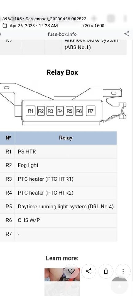

    I suppose you could check the relay that controls the CHS pump. Lives in the relay box above the engine valve cover. relayA.jpeg relayB.jpeg

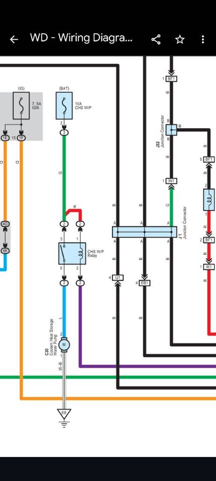

    The relay position in the box (rear of engine compartment, passenger side) is shown in the wiring2 PDF.
    A black and white variant of the diagram in the preceding post is shown in wiring1 PDF.
    How to read the diagram in previous post to identify which pin is which:
    Pin 1 to the pump is a White/Black (W-B) wire and goes to ground
    Pin 2 to the pump is a Blue (L) wire and will be 12V when switched on
