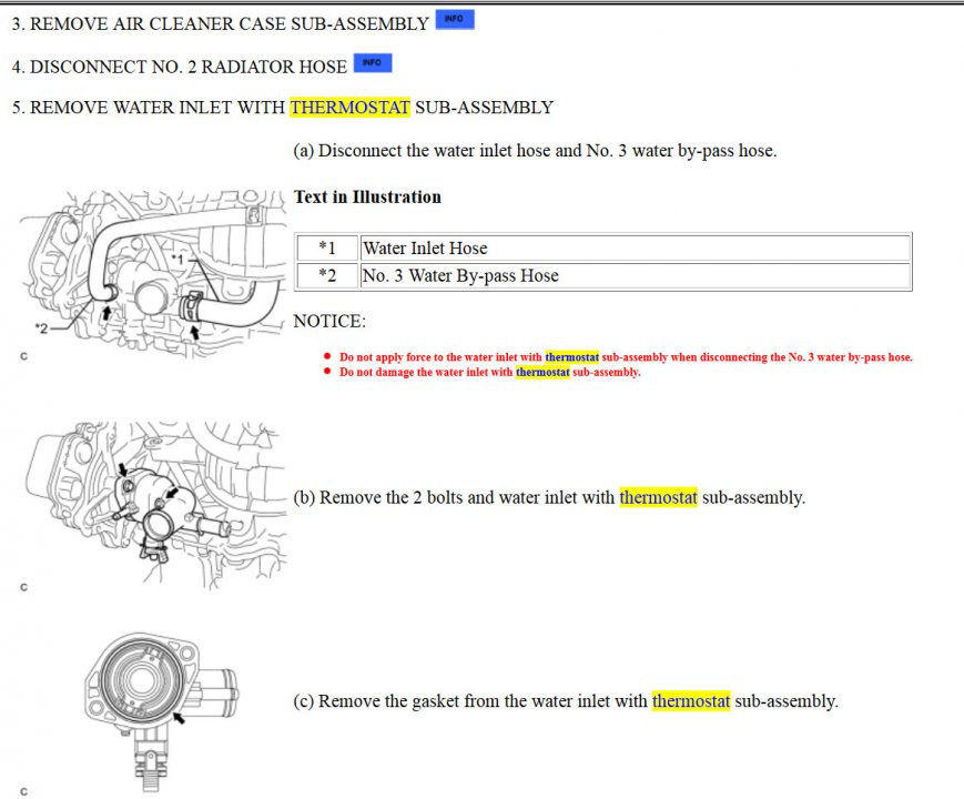

    Hello, new member here. Just got my new 2012 prius C two last week, so far It's been great. Just been doing some reading around on here, thought I saw a post that said Prius C doesn't have a coolant thermostat? Is this true?

    Unless the c is different than the Liftback it has a coolant thermostat.

    The C does have a thermostat it just does not have gauge, if you want to know the coolant temp you need to get a scan gauge or something similar.

    Yes! It has a T-Stat. It has an electric water pump, but no drivebelt.

    ah very nice, can't believe I didn't just look it up on my old mitchell on demand account

    Me either but you can be sure the Yaris/Prius has one. Good warmup is essential. Can't imagine why it would be a problem for a least 50k miles. Being devices they will fail eventually.
