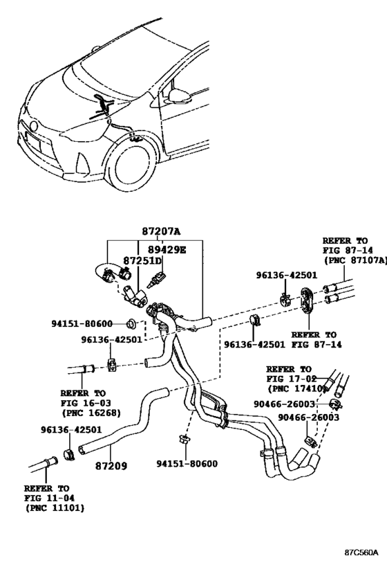

  12. MAX2
    MAX2 Senior Member
    Aug 12, 2024
    1,436
    490
    101
    Third planet from the Sun
    89429E
    89429-47010
    WATER TEMPERATURE [12.2011 - 12.2014] NHP10
  13. ChapmanF
    28,731
    19,026
    If that's a Prius c diagram then it appears the c has the exhaust heat recovery system like the liftback, and the sensor shown there as 89429E is almost certainly the EHRS one. If the similarities to the liftback hold, then a concerning reading from that sensor would give a B1503 code, and the engine coolant sensor (the one a P0117 code is about) will be one that's threaded into the cylinder head.
    Brian1954 likes this.
  14. MAX2
    MAX2 Senior Member
    Aug 12, 2024
    1,436
    490
    101
    Yes, that's right. The second temperature sensor is on the cylinder head.
