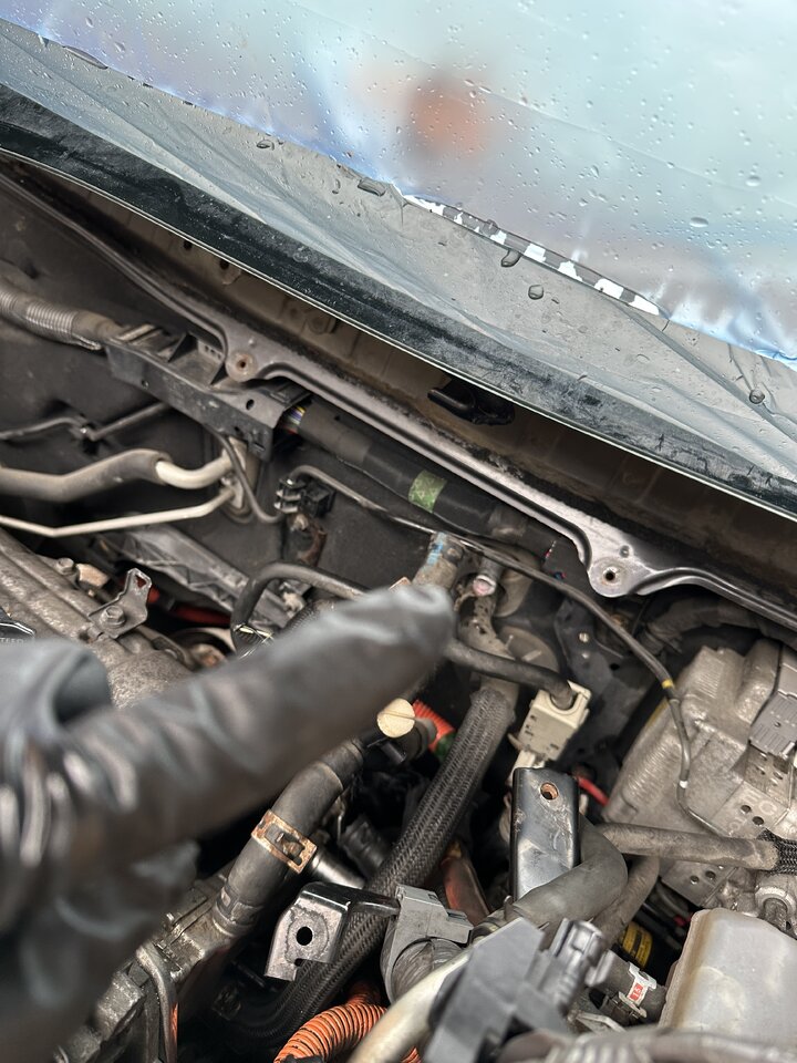

    Anyone have a part number from Toyota for this hose on a 2006 Prius? (circled in red)

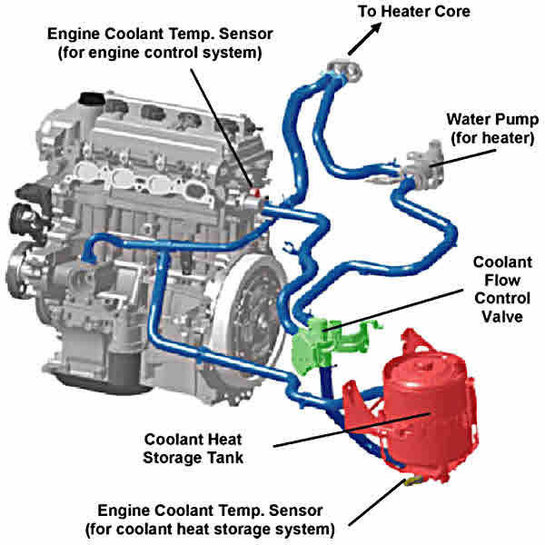

    SFO's engine coolant diagram although very nice doesn't show the connections to the throttle body or the radiator but is good for the 3 way valve.

    What gen is this a diagram for?
  18. SFO
    SFO Senior Member
    Feb 7, 2017
    5,302
    4,252
    Northern California
    That would be the Gen2 platform, which is what this thread is about.
