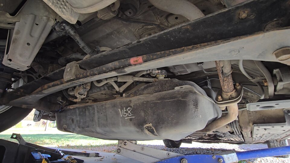

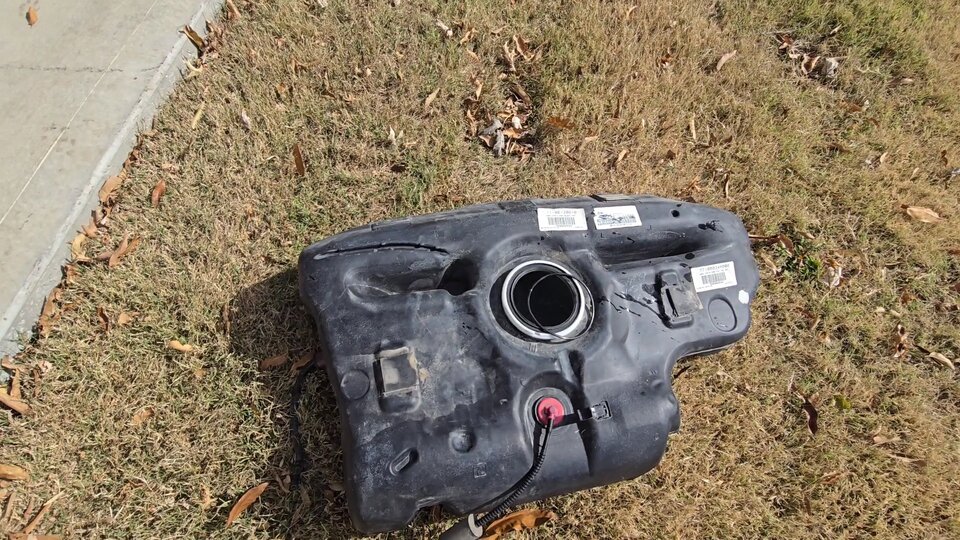

    VideoCapture_20251123-213938.jpg First removed the tank.
    Over view of the system.

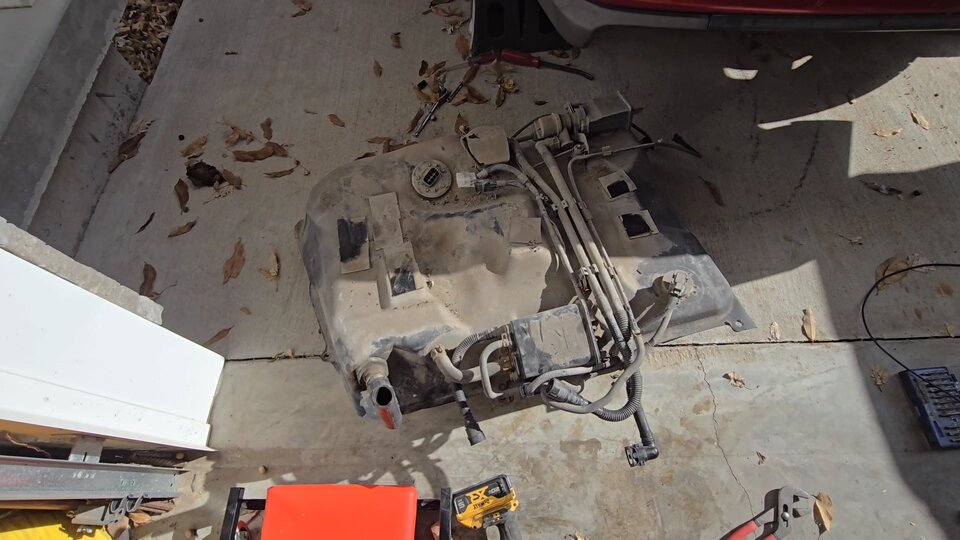

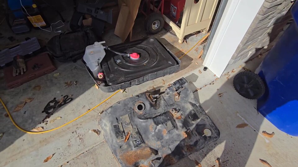

    Prep Corolla tank.

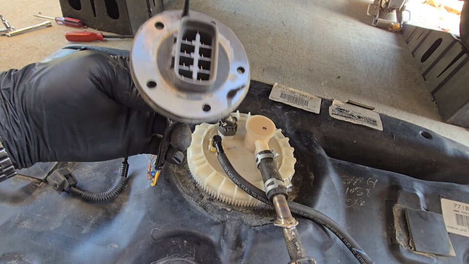

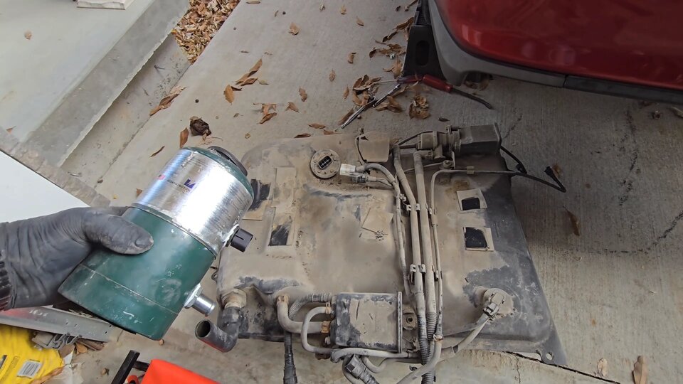

    Gut the junkyard tank for fittings, sensors, and wiring.

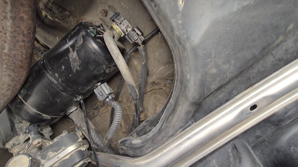

    In my video I go into more detail about this but I used an old Coleman propane tank for a vacuum manifold. With this I put the tank sensors associated with the bladder into it and this allows them to communicate with each other even though there is no "gas tank void" for it to monitor anymore.

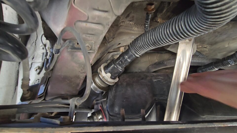

    Used the gutted junk yard tanks filler pipe fitting so I could connect to the prius filler neck.
    Here is where I used the Corolla filter neck and connections to make the necessary bends and connections that I needed.

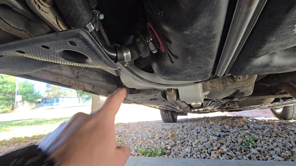

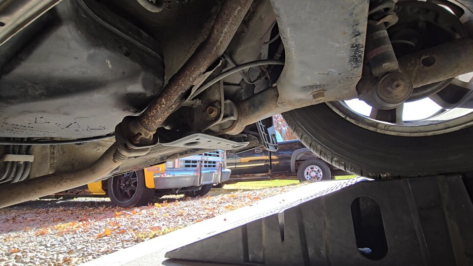

    Just showing how close the stuck exhaust is to the tank when installed. I was able to move a few things and create an air gap between the two. For those that are going to cry that it's too close... Cool I get it. Drive it over 800 miles and no signs of wear or burns. Jog on.

    The harness I pulled from the junk yard tank to use as a conversion harness.
    In a nut shell that's how I did the swap. I did have a couple of check engine lights at the beginning. After I cleared them and sealed some leaks it did fine. Drove like this for a week and did have fuel gauge issues but that was because the sender unit from the yard was bad.
