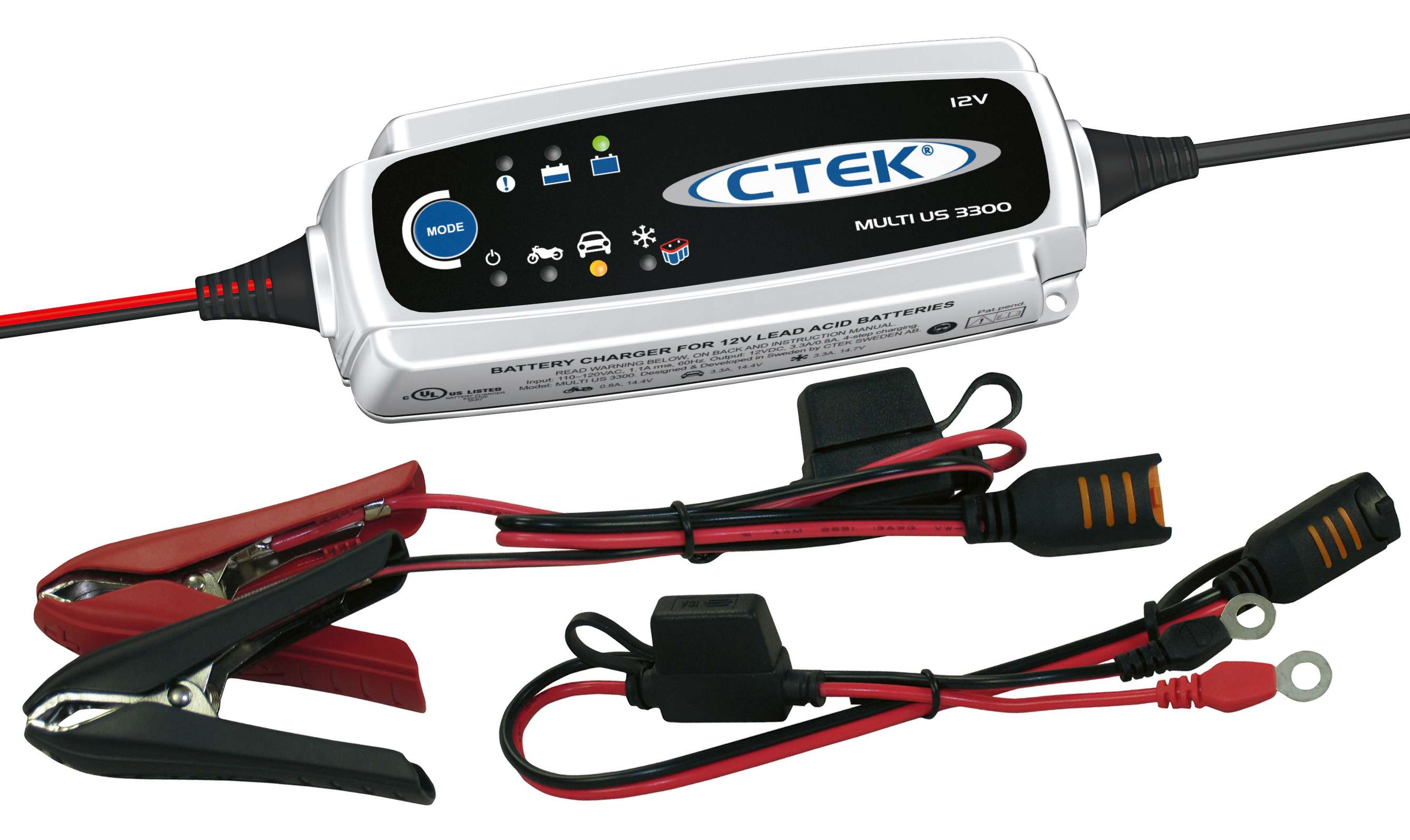

    2002 Prius
    Brother Steve,
    Quick Question and Sorry if you answered this already.
    While I have her apart should I attempt to trickle charge some of the lower modules with my C-tek 3300 on it's lowest setting. I like the C-tek because it has a maintenance cycle to de-sulfate a battery to lengthen it's life. I have a car battery that is 10+ years old, using the C-tek has kept it healthy all these years.
    Maybe connect 2 at a time to keep it at around 14-16 volts max using a bus copper connector in series +/- +/- then connect the C-tek to charge and maintain it while I am working on the replacement. Maybe my thinking is not valid, huh?
    TIA,
    Jim

    As S Keith points out... Be very, very careful.
    Watch the polarity of your connections!
    You do not want to reverse things.
    Making a mistake with this level of voltage would really suck.
    Adding a diode, fuse, or switch into the mix is an idea as well.
