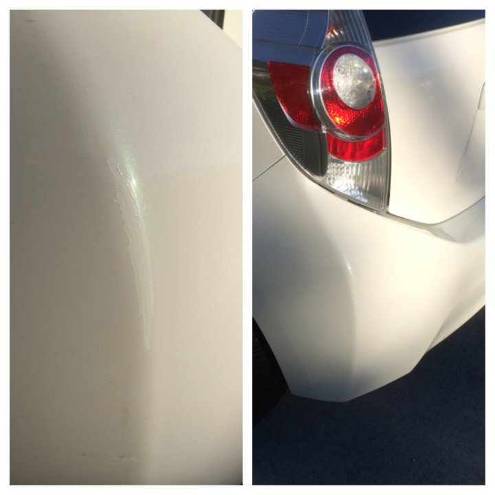

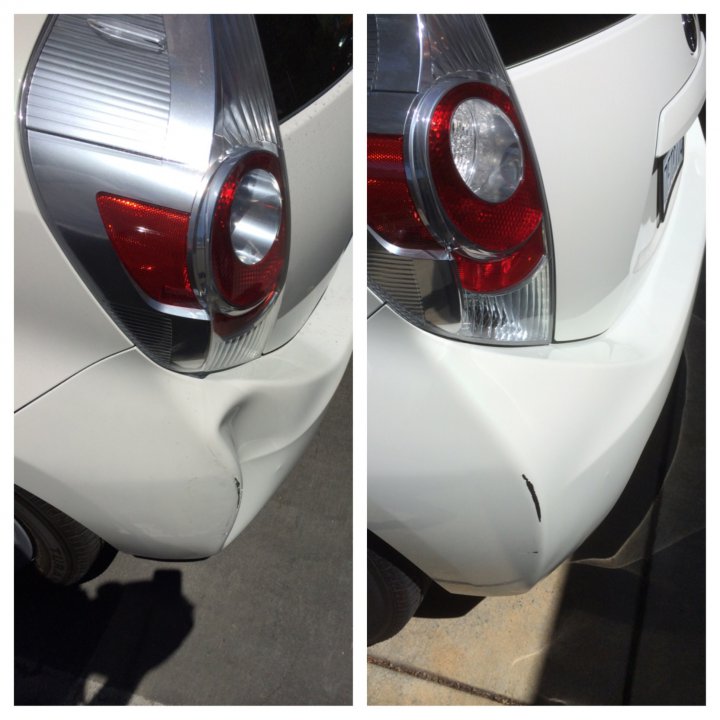

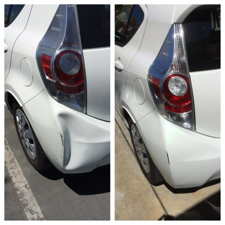

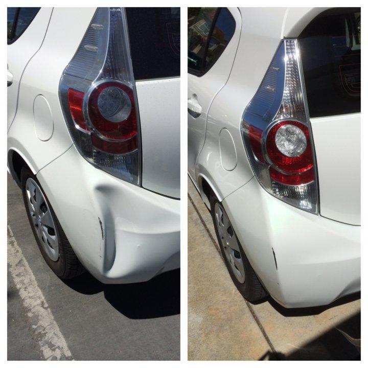

    Had my C for just about a month and some jackass crunched my bumper on Friday at work. Didn't leave a note and it was out of view of security cameras. (Incidentally, our lot is patrolled by a fleet of white Prius... Thanks for lookin out for one your own...) I was waiting for the first scratch but a dent at work, one month in?! So frustrating.
    Anyhow, after lurking this thread and pricing out bumpers online, I figured I'd give in to my OCD and replace the whole bumper cover. But then I started browsing dent repair on YouTube and man, watching things on YT makes you feel like you can do anything. I ran out this morning and bought a heat gun and decided to try to push the dent out. After a minute, I had fears of melting the moonglow right off so I ran back to the hardware store and bought a torq wrench to remove the bumper. I set it down on a pillow while my girlfriend held it up and warmed the area with the gun. I stepped on the dent from the back and it popped out easily. We spent another 10-15 minutes warming the deformation and "stepping" it out. I took a wet cloth and rubbed it a bit, hoping to help the plastic set. It's not perfect but it doesn't infuriate me as much looking at it now. Toyota parts was closed so I'm going to hunt down some touch up paint tomorrow and see what I can do about the scrapes. If anyone comes across a place that ships or sells already painted bumper covers, let us know. I'd just pop that thing on myself. Some before and after:

    Great job well done, let me know how you do the paint as I need to touch up mine where a friends gate bashed it, and a panel shop wants $650 AUD to repaint it

    Great job, PCSF. I'm sure the best part was the satisfaction of doing it yourself. A bit of touch up paint on the edge should make that look good as new (at least from a distance).

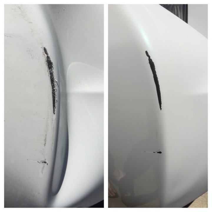

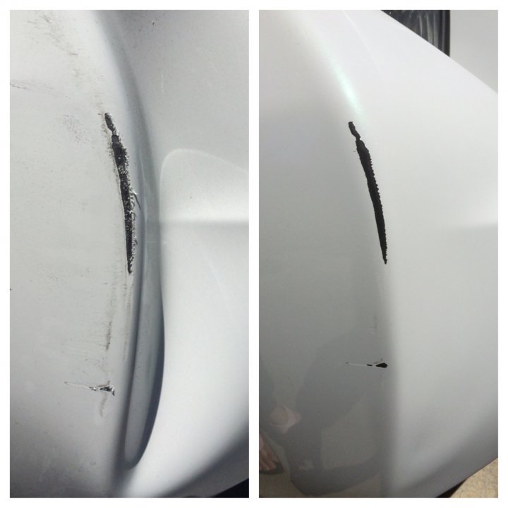

    Work's been busy so I haven't been able to work on this much. I got the touch up paint from Toyota. Moonglow involves a base coat white and a "pearly" coat over that. I laid down two coats of base (with an hour of drying in between) before I got called into work again. But here's what that looks like so far:
