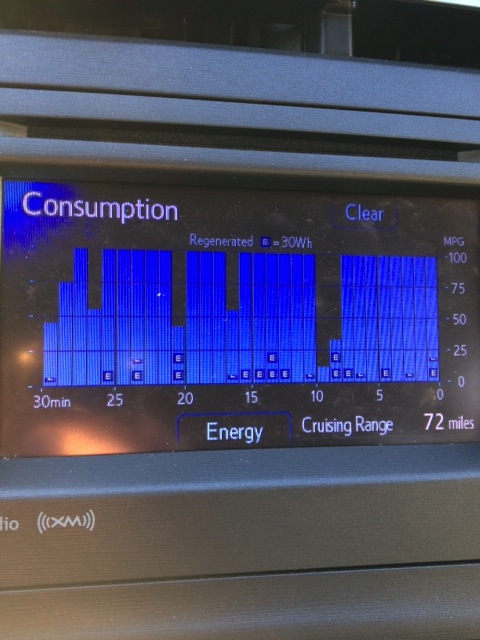

    Here's my EV reading from this morning, with ICE starting up along with the heater. I still seem to be getting mostly EV miles, so I'm confused as to how the ICE is dissipating that, except for the obvious times shown on the screen. Image.jpg

    That's a lot of regeneration! Are you trying to time lights at all?

    Remember your consumption screen only goes to 100 MPG, your car still could be using gas and your getting more than 100 MPG with the gas helping, so not all EV miles, gas is helping some. Screen can be a little misleading.

    I agree. I was pointing out that it would not increase the EV miles (as OP indicated).

    Just because you got higher than 100 MPG does not mean it is EV mile.
    You need to be in the "EV Driving Ratio" screen (see below for mine) to see the miles roll into either EV or HV side.

    Certainly in the warm-up session you get many times over 100 MPG.
    Your 'consumption' screen should be in fact called efficiency screen. We, with the European model have this screen in liters per 100 km (the smaller the bar - the better) so really a consumption screen, and I can see sometimes 2 l/100 or less on it during warm-up.
