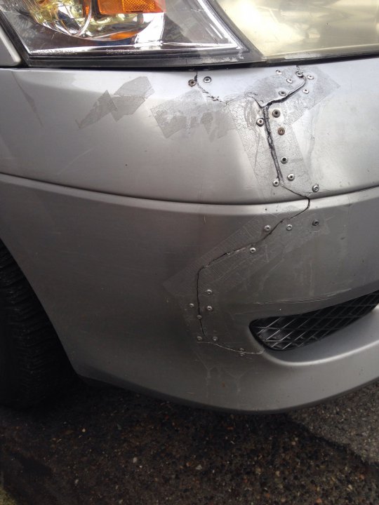

    Unfortunately i was going a lil fast in a turn and turns out the snow was turned into ice due to the really cold temps today (-3 F) and i hit a snow bank head on :(.
    My car is a '14 lease and i'm not sure how much i'll be charged for this damage.
    This is what happened :(
    Also, f%!@ the traction control.
    Anybody know if i can just fix the crack some cheap way? It's only about an inch in length.
    Thanks.

  2. valde3
    valde3 Senior Member
    Jun 28, 2014
    2,002
    750
    Finland
    Most of the bumper plastics can be plastic welded. If you do that correctly it will be just as strong as new and will only look like scratch (that can be painted with touch up paint). Bumper cover (probably) needs to be removed to repair. Proses itself depends on type of plastic which I don’t know but it should be written on the back of it.
  3. Okinawa
    Okinawa Senior Member
    Dec 28, 2013
    1,333
    320
    I had about a 2 year old 1998 Camry. I was going extremely slow preparing to enter my driveway. I started sliding, like you, hit a frozen snow bank beside my driveway and the front bumper cracked, much larger than your's. I bought some auto plastic glue that you mix in equal parts and glued it together when the weather turned warm. I then touched it up. The broken parts fit perfectly together. It was not perfect but it looked good enough. Your car is a leased car. I would imagine you will have to get a body shop to do a pro job on it otherwise when you turn the car in you may have to pay for the damage. These lousy plastic bumpers will crack like glass when the temp is really cold.

  7. valde3
    Jun 28, 2014
    2,002
    750
    Finland
    Plastic welding the crack will get it to look like just a scratch. Then it depends on painter and lease company policy on what to do after that. Touch up paint or partially or fully painting the bumper.

  10. Husam
    Husam New Member
    Jul 10, 2014
    I went to a professional body shop, and guess what? $750! as they want to replace the whole bumper
    I might buy a used one off ebay in the same color and just install it myself, since i'm not wasting money on a car i'm not keeping.
