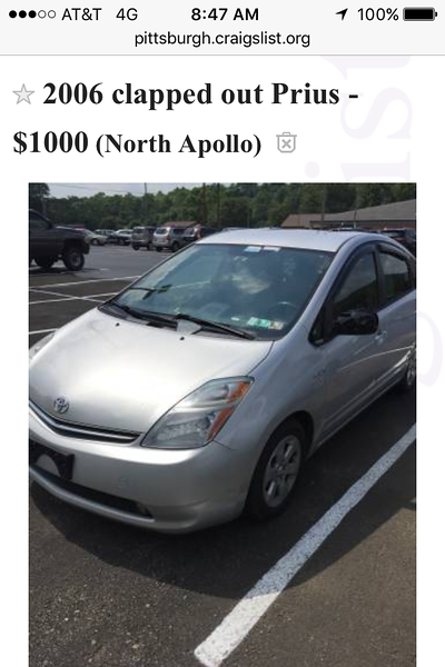

    Found this on Craigslist, going to look at it now. Any ideas what's wrong? I'm leaving shortly to go look at it, should be there in about 3 hours.

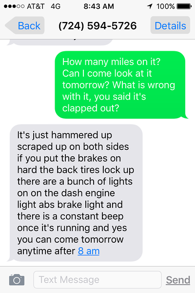

    He (she?) texted me again and said 'I cleared an abs code for the acc sensor and all the lights turned off yesterday' in regard to the warning lights.

    don't take the poster's word on the HV battery. if you have a code scanner, bring it. "codes cleared" seems fishy. take it for a test-drive, and push the car hard. install uber on your phone, incase you need a ride back to your car.

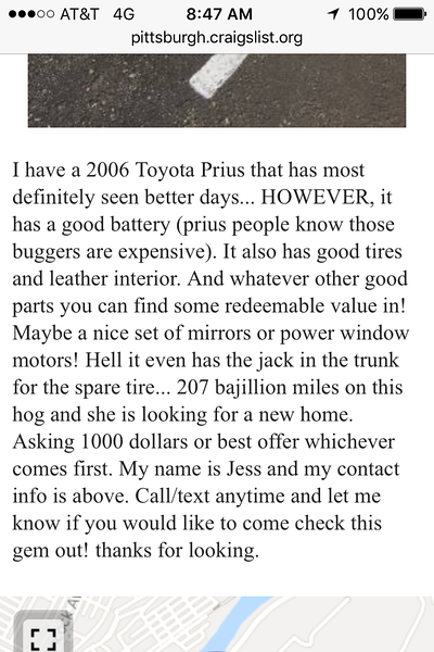

    How would I know the HV battery is going bad? If it's going bad I'm not against replacing it, only $1400. Id have $2400 in the car at that point.

    Sounds like the brake/abs/skid control might be out. That might be solved with a $40 used ECU or it could be the brake accumulator is going out ($$$$) which is not a DIY repair for most folks. Car is throwing codes, so codes need to be read to get a better understanding.

    What do you want it for?
    Looks like the seller is promoting it as nearly a parts vehicle.
    The way the seller is promoting it? I certainly wouldn't be investing into it as a vehicle I had much hope of driving very long without significant investment. The red flags are "Has definitely seen better days" and referring to it as a Hog...
    And the endorsement of the HV battery isn't promoted as being anything but it's still working.
    So for $1000 you get an HV battery that hasn't yet failed?
    I wouldn't look at this any more seriously than as a potential parts vehicle, and even then, my interest would be nearly non-existent.
