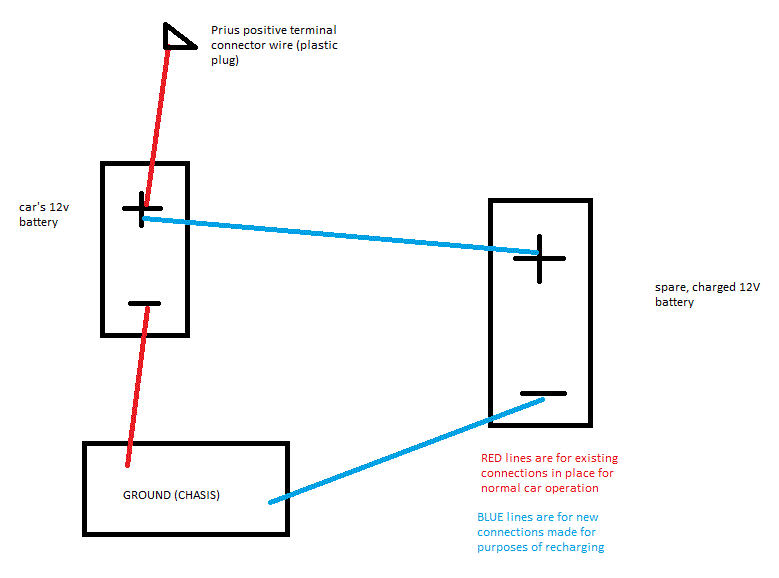

    hook the positive (red) to positive and the negative (black) on the spare to a ground point on the chassis.

    I don't have to disconnect the drained 12V from the car (+) or chasis (-), do I?
    Like this?
    And after I make that set up with the Prius, do I just start it while it's connected or do I wait for it to charge, disconnect the spare, and then start? If the latter, then is it safer to disconnect the positive cable Prius cable from the drained battery while charging for safety?

    correct set up, and you can just press the power button. if it won't go into ready, that means the in place battery is defective and needs to be replaced.

    Except maybe for difficulty finding an appropriate connection point, it's exactly the same as jumping any vehicle.

    You are making this much harder than it IS.
    Either method will work.
    Nothing in the car needs to be disconnected.
    If you start it right away, disconnect one jumper lead as soon as you can after the car starts.
    I prefer the "let it sit and charge" method because that way you can have everything back to "normal" before starting.[/QUOTE]

    Power button? I have a shifter and turn the key to start my car.
    Finding the connection point? I assume I only need to know the location of the two leads on each battery and a metal point on the chasis.
