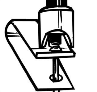

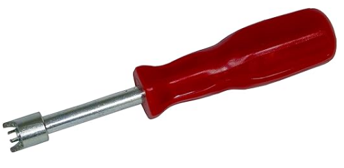

    1. Remove the spring clamps that keep the shoes tight against the backing plate, pry the shoes away from the backing plate, and with something like a chopstick tip, sneak in a little dab of grease at the three contact points between shoe edge and backing plate. i've always managed to get those spring clamps off and back on with just pliers tips, but it takes 3 hands, 150% of your strength and swearing. There is a tool that helps immensly, i think looks like this:
    in use:
    I think @ChapmanF has said he manages do the lube application without removal of the clip, just pry up and leave something wedged in the gap. If there's ever another time maybe I'll try that.
