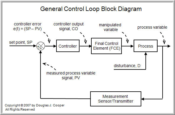

    That is because some people don't know anything about control theory. They don't realize that the feedback loop works according to the error signal, in this case about ±1 mph. Trying to make this error smaller can cause other problems, worsen fuel economy, etc.
    Control theory—Wikipedia
