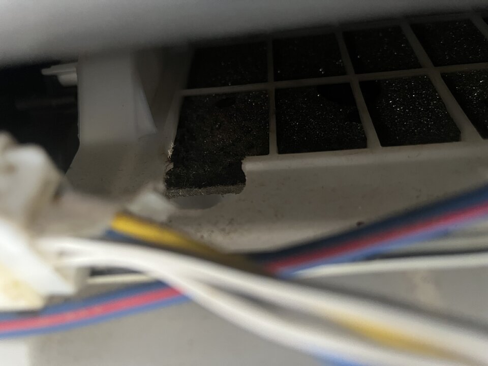

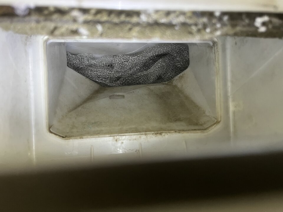

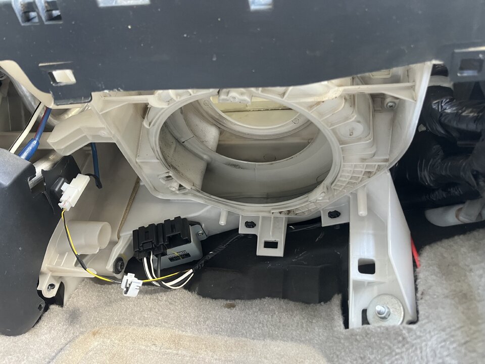

    Upon further inspection of the cabin air filter area, I discovered they had chewed a hole through the plastic next to the damper, so they were getting in and out without having to penetrate the cabin air filter. I think I've FINALLY found a solution. I removed the blower motor below the cabin air filter and stuffed the better part of 2 rolls of stainless steel mesh into the air intake, pushing some into the gaps on each side as well as filling the space in between. The mesh shouldn't block the air flow too badly since it is air permeable, but the mice don't seem to want to deal with it.

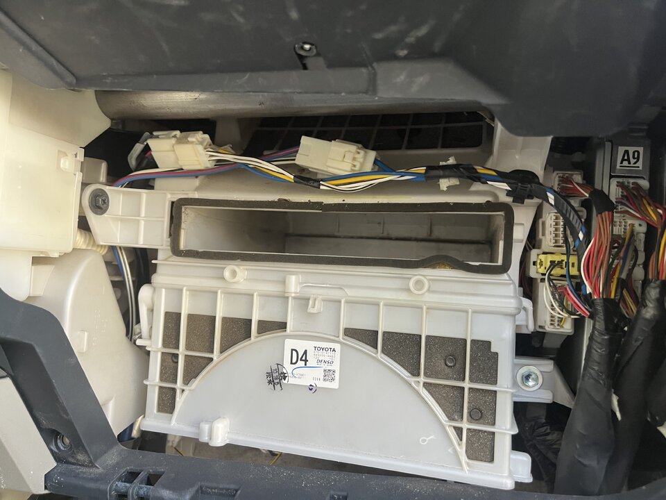

    IMG_8502.jpeg Looking at the cabin air filter assembly
    IMG_8500.jpeg Hole above cabin air filter that mice chewed through plastic
    Blower motor removed for access from below cabin air filter assembly.
    IMG_8507.jpeg View of air intake stuffed with stainless steel mesh (camera looking in from cabin air filter slot)

    While it may be 'permeable', that kinda looks like it would increase airflow resistance more than a bit.

    I'm sure it will, but I'm getting desperate here!
    I'm doubtful it will be an issue. The air is already passing through the cabin air filter, after all. The bigger concern might be debris getting caught in the mesh and blocking the air flow over time. So far I haven't noticed any difference in the blower performance.
