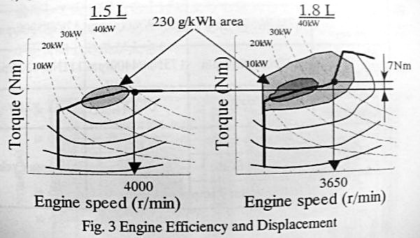

    There are very tiny situations where Gen 2 is more fuel efficient than Gen3, mostly 55 to 60 MPH range. If that is where you drive, it is hard to beat a Gen 2; by 70 MPH, the Gen 3 wins big.

    This chart shows engine efficiency, the 1.8 is more efficient over a broader range of RPMs, but the are spots where the 1.5 is as good.
    I did not suceed in googling the Gen 4 graph
