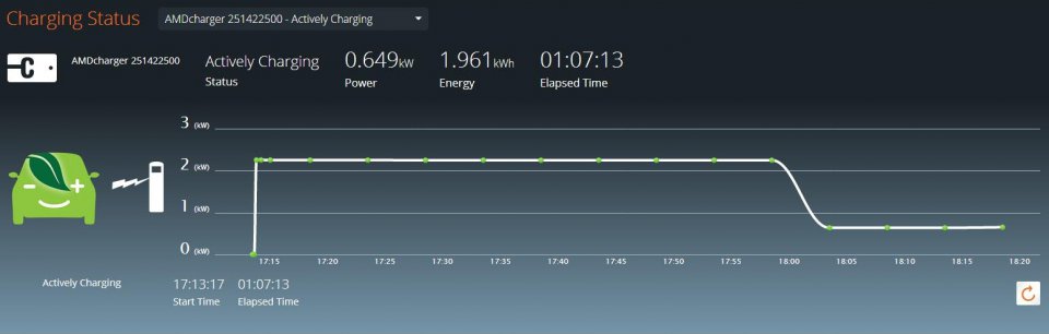

    Here is what the charging looks like from a public 240v ChargePoint

    Mine follows the graph above. 230V, 10A for the best part of an hour then drop to around 2.5A for half an hour or so, it varies.

    Interesting... 1.96 kWh is not a full charge. I suspect you know that :)

    3priusmike - thanks for the graph. This is the first time I have seen one like this and it answers my query perfectly. 10 Amps is what my domestic supply will be asked to deliver. I have a recently installed 13 Amp standalone supply in my porch that I will use initially but my garage has a 13 Amp spurred supply that I hope to use long term. My problem with installing a dedicated Chargepoint is that between my mains incomer fuse board and the car port where I will keep the PiP is a living room wooden floor and a concrete garage floor. I doubt that the installers will look on this distance favourably as the extent of the work required to burrow will probably mean that they will lose money on the job. I would be happy to extend the garage spur to the carport but I am uneasy about doing this given the fact that this is a spur off the ring main. Your plot shows me what I need to plan for.

    Your Prius charger will draw about 10 amps, period. If you use the Toyota supplied charging cord which plugs into standard 110 volt house current it draws 10 amps. If you buy an aftermarket charger which charges at 220 volts it also draws 10 amps. The 220 volt unit will charge your PIP battery in less than 1.5 hours, while the Toyota supplied cable takes about 2.5 hours.
    As 3PriusMike shows earlier in this post, most of your charge is completed in about an hour at 220 volts. So if you are making a lot of short trips on the weekend, you can charge up to nearly full in an hour. If you go to the mall where there are chargers, same thing. In an hour of shopping you have a nearly full charge.
    But what does this mean for you? My over night, full charge shows about 15+ miles of EV driving on the PIP display. In an hour, the charge shows about 13.5 miles of EV driving on the display. These numbers come from the situation where you have fully depleted the PIP battery before recharge and the car is behaving like a standard Prius hybrid. At 220 volts you get nearly a full charge in about an hour.
