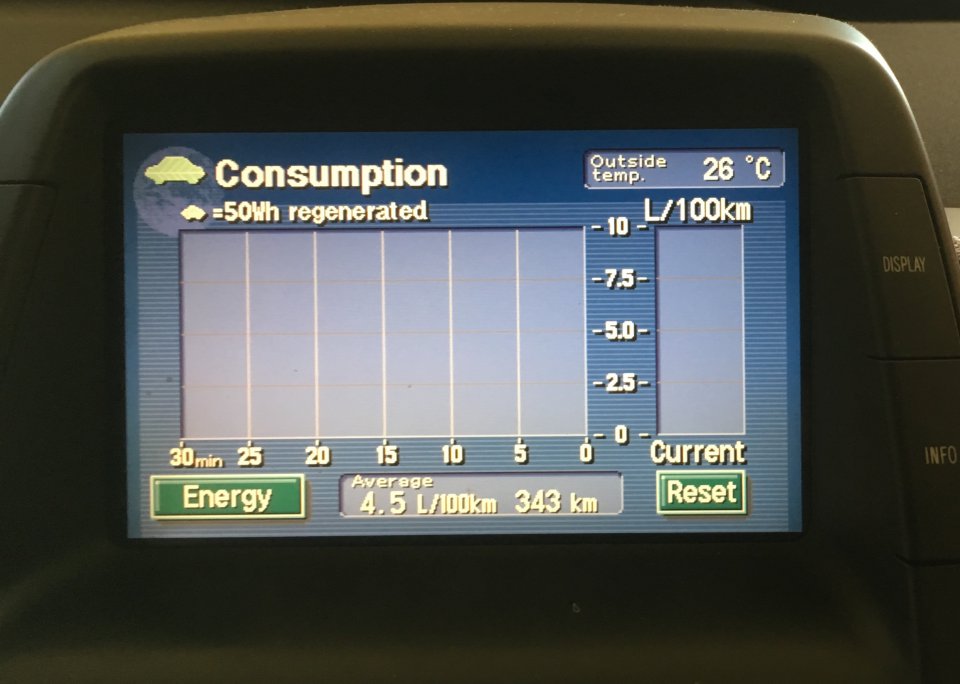

    Our meter (continental Europe) works differently: Americans divide distance by gallons. We divide gallons by distance (actually liters per 100km, but same difference).
    This means that the bar on the right should be as big as possible in the US, but as tiny as possible for us.
    Iirc, it will also sometimes get confused because it is dividing zero (fuel use) by distance. It will then show 99,9l/100km.
    So my Prius will sometimes claim to use (the equivalent of) 2 MPG...:D You'd be hard pressed to reach that with a Hummer towing a 100ft yacht...
    (I think I should have a pic of this, but cannot find it. Obviously this only happens right after putting in gas, resetting the computer and driving off without using the ICE, so purely on the HV battery.)
