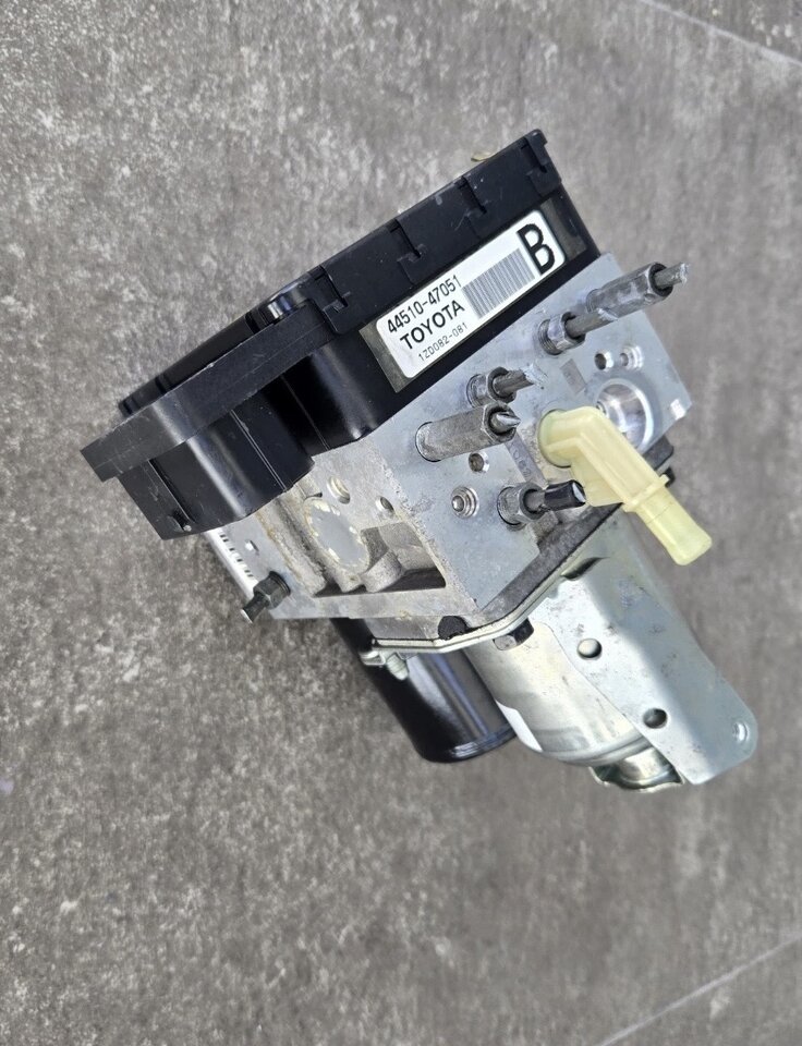

    Okay, so I just found and ordered on eBay a 44510-47051 which is on the sticker on the actual part. Assuming that is what is sent to me, that is the correct part?

    It could be. Here's a listing looked up by the correct part number, and you can see in one of the photos it has a sticker with your number on it.
    https://toyota.oempartsonline.com/oem-parts/toyota-actuator-assembly-brake-4450047141
    To be sure you've got the right part, you'd have to assume that the same non-part-number you see only ever appeared on one part, namely the one with the right part number.
    That can be a lot to assume (the number could be on a casting or cover that was used on multiple versions of the part), but for these gen 2 actuators it might happen to be true. Plenty of posters seem to think so.

    Ok, I see what you mean by the listed ‘catalog’ part-number and the part-number on the actual part. On the website/catalog it’s listed as 44500-47141. But on the physical part itself the sticker is 44510-47051. Here’s a picture of mine from eBay. It looks to have the same sticker so I may have hit the actuator lottery and found the updated version, which I assume has a higher probability of being a good part.
    Thanks so much for this info. TBH after watching 3-4 different install videos I felt better about actually doing the job, but finding the right one on the used market then became my concern. A ton of -05 ones out there with a bunch of different numbers I was told to buy from different websites.
    So it seems like the -05 were the faulty ones. Do you know if there was a model year that Toyota eventually started installing the fixed -51 actuators or did the issue start popping up after they switched to Gen3 models so that the -51 actuators was installed by dealer service? I know the one I have on order is used, so just curious is it means it’s from a car that went thru the fix or if it was from like a later 2009 model?

    When there is a number visible on a part that isn't the part number, it isn't the part number. It's just a number that's visible on the part. This happens quite often with Toyota parts.
    So, you have a number that's visible on the part you got that's the same as the number that's visible in a photo of the correct part. That's a good sign (at least better than having the numbers be different). Still, that's a number that isn't the part number. Calling it the part number sets up confusion for other people who might come to PriusChat later and be reading the thread.
