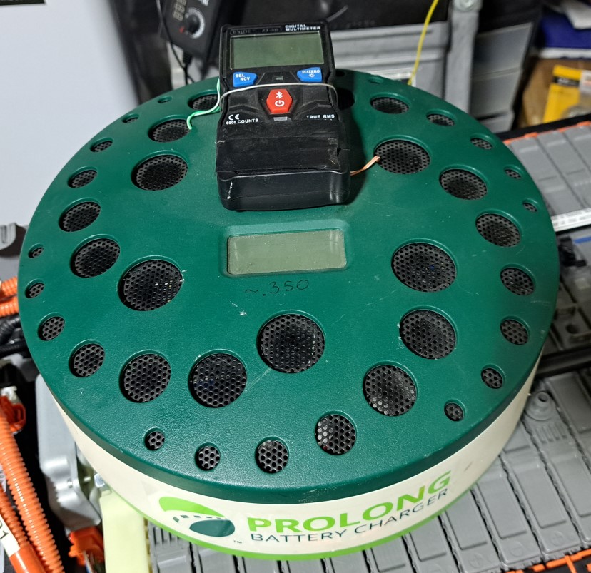

    Okay, the 1st attempt using the original (125K mile) battery in the 2011 CT200H is a fail. This was with the Prolong charger discharger running 3 charge/discharge cycles, and taking about 4 days. It's hard coding P0A80 and the Prius app says 23% life, which is the same as the original test.
    Further reading and watching YouTube vids it looks like amp hour capacity of the modules is the true test of the battery. And it's how a lot of techs determine if a module is re-usable or not. And most DIY techs are using hobby chargers and chg/dischging individual modules to get an amp/hour reading. With up to 5 chg/dischg cycles to get the modules to a usable amp/hour capacity level.
    I'm probably not doing everything right yet either, like there's one tech that balances the blocks with each other using a low/high module in each block, essentially averaging/equalizing the amp/hour capacity of all the blocks.
    Also could have done more cycles with the Prolong, only did 3 and techs that charge modules individually go up to 5 cycles.
    Another thing is balancing. The Prolong balances using overcharging and their tech says it's a different kind of balance than how a lot of YouTube vids show stacking the modules all facing the same direction and wiring them in parallel and leaving it sit overnight, going to try both ways.
    Going to retry with this battery using the individual module chg/discharge amp/hour capacity test to find bad modules. Using the Tenergy T-180 100W Intelligent Balance Charger. $75 on Amazon. Prolong has a module tester but it's professional level at $900.
    It's more time consuming doing individual modules, up to 6 hrs per, so will be looking at the other readings previously taken to see if one of the quicker tests correlates to a bad capacity reading.
    Also there's a lot of different opinions on how low to go on the discharge volts, between 6V per module on most YouTube vids, 3V with the Prolong, and others going even lower.
    There's also different opinions on what's a good amp/hr reading. With 6.5 amp/hour being new and 5.5 being a good minimum but as low as 5.0 being usable.

    You need to find the reason why it didn't work, rather than panic. You already have the Prolong charger. That's all you need to restore the battery capacity along with replacing bad modules. The discharger that discharges only up to 84 volts... to me it's useless, but even after discharging to 84 volts, the result will not be bad. The battery with 125k miles shouldn't be that dead. I tried to restore a battery from a 2013 prius with 186k miles. The owner was told first of all that the battery needed to be replaced, as the battery filter was clogged badly and the Dr. prius test showed 13% of life. After three cycles the dr. prius test showed over 60% of life, with still 5 weak modules in the pack that needed to be replaced.
    Have you cleared the P0A80 code from the hybrid computer? Gen 3 does not erase the P0A80 code until it is erased with a scanner. If the code was erased and reappeared, what was the percentage of delta soc?
    What voltage was the battery charged to at each cycle?
    Has the battery cooling been used? If you do not use cooling, the battery will heat up and the charge will go into heat, and the voltage will not even reach 235 volts. On a low miles battery, the voltage reaches 237-239 volts. On a worn battery, it can reach 243 volts.
    You don't need to cycle it 5 times. 3 times is enough while 1 cycle is not enough.
    If this is an original battery with all original modules, then the difference between the modules should be not higher than 0.03 volts after cycling it 3 times. Discharge the entire battery to 40%, wait 10 minutes until the voltage settles and measure the voltage on each module. The lowest voltage on a bad module will be visible.
