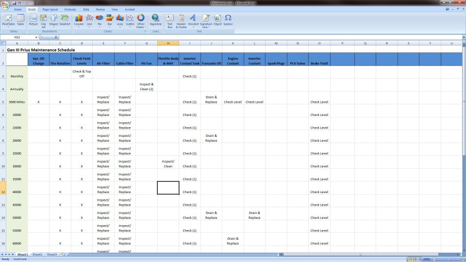

    Hello all! I have been taking in knowledge from this forum over the years and just created a maintenance schedule based on what I have learned. I would love any input to improve it! Please feel free to download the file and customize it for yourself! (I work in the computer field and the file is safe...) I also included a snapshot of the sheet for you to preview.

    @Eclipse1701d Thanks so much for making this! I'm having issues opening the file w/out if jacking up the cell sizes. Would you mind uploading a pdf of the same file? I have a 2007- do you think this file is still applicable?

    my question is on the transaxle oil you suggest to change more or less 30k
    but not the engine oil ?? no break fluid up to 120k ??? not even by time ??
    The problem is is that engine oil change is about 50 dollar at the dealer the transaxle they are asking 140 !!! ridiculues..
    something is not right with this table sorry please.
