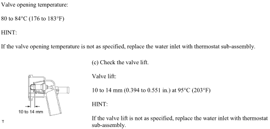

    Hold the phone a sec. The thermostat lives in the water inlet elbow, where the water from the radiator is returning to the water pump, to be pumped into the block. The engine outlet is from the cylinder head and at the other end of the engine.
    The sensor that gives the ECM its displayed engine temperature is at the outlet. But that doesn't control the thermostat. The thermostat is its own expanding-wax-pellet operation and only knows the coolant temperature right where it happens to be. (It is able to respond during warmup, when it's closed, because the bypass loop also returns there, the one that involves the cabin heater, EGR cooler, EHRS, and throttle body.)
    The wax thermostat is opening between something like 83 and 87 ℃. Sure, if the coolant coming back from the radiator is cooler than that, the 'stat will close some to keep the temperature higher. But once the 'stat is fully open, there's no further effect it can have on how high the coolant temp gets.

    Yeah, your memory is better than mine. Sho'nuff, Toyota says starts to open at 80 to 84 ℃, fully open at 95 ℃. That's a range of 11 to 15 Celsius degrees, even more if we were using Fahrenheit.
    That 95 ℃, though, is exactly the temperature that turns the radiator fans on, so it's not an unheard-of temperature to reach in practice. (That would be ECM-detected outlet temperature though, not what the 'stat sees at the inlet.)
