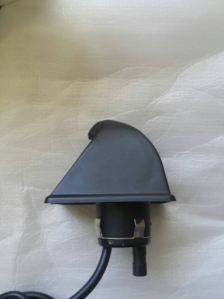

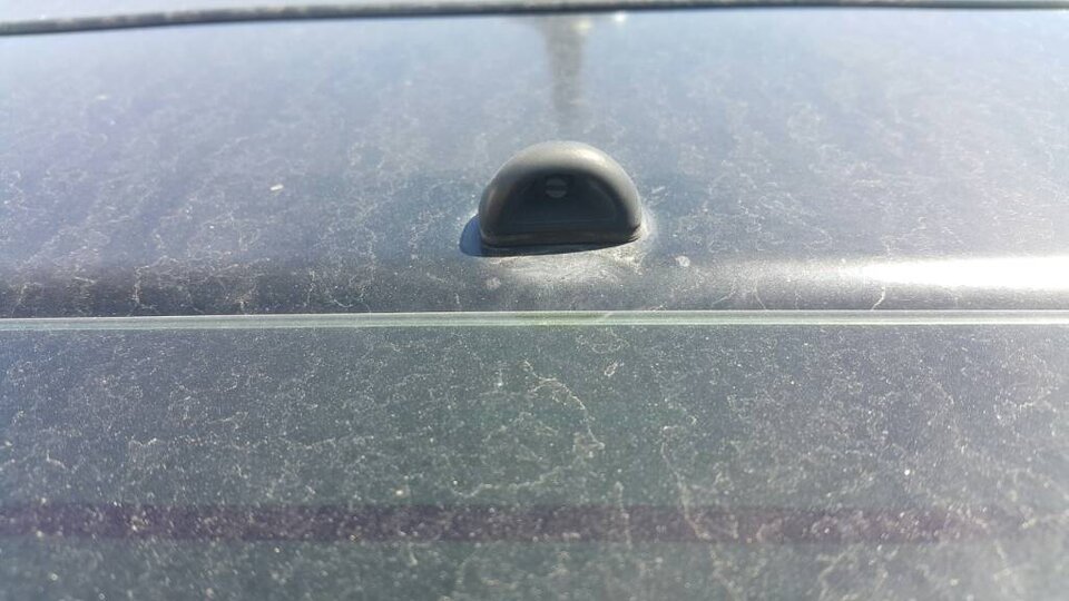

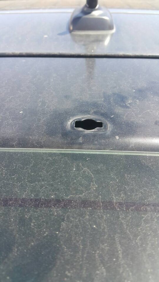

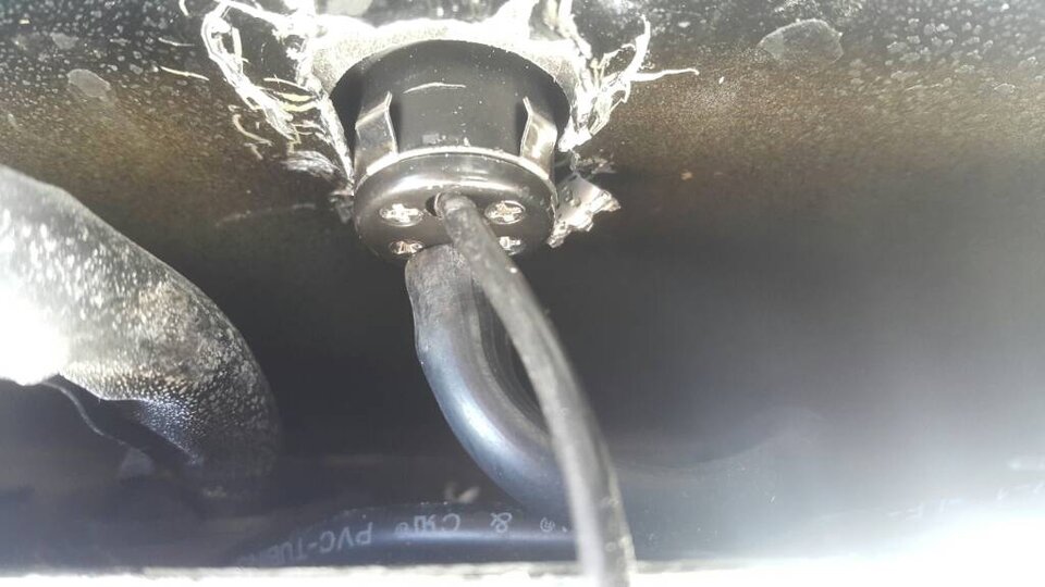

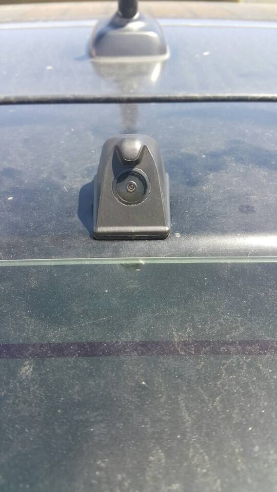

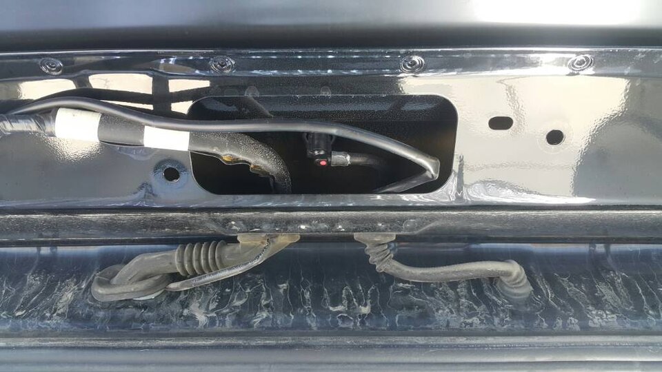

    I did the rear wiper delete a long time ago.
    Then I felt the rear washer was useless but wanted to try something out.

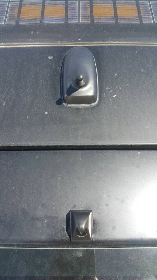

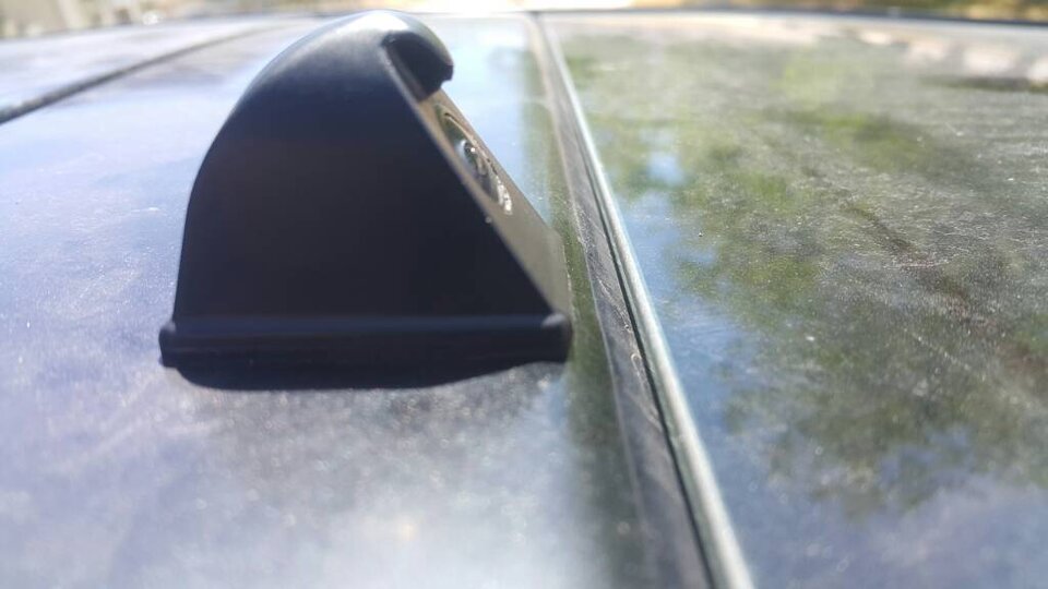

    Install a camera in its location with benefits.

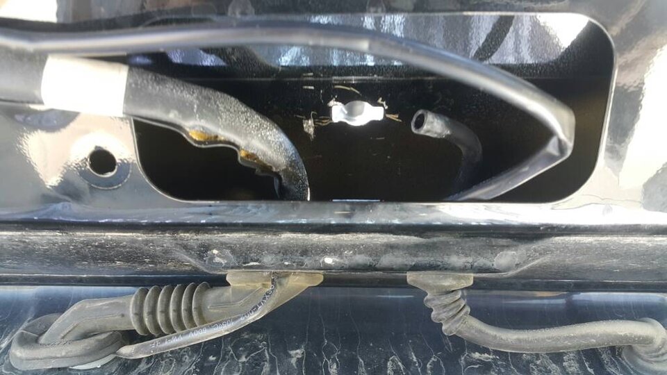

    Tap into the power and ground for the rear wiper motor.
    I now have a rear camera that I can activate at any time parked or driving.
    I just use the factory stock rear wiper switch to activate the camera.
    When the camera lens gets dirty, I can just activate the washer and clean the lens.
    This will connect to my aftermarket android radio.
    I have not completed the installation yet.
    So I will upload images of the camera view once I finish with everything
    Was excited and wanted to share my idea.
    Other installation pictures to come. 20260404_124637.jpeg 20260404_124621.jpeg 20260404_125704.jpeg 20260404_125634.jpeg 20260404_123713.jpeg 20260404_133156.jpeg 20260404_133229.jpeg 20260404_133216.jpeg 20260404_133334.jpeg
