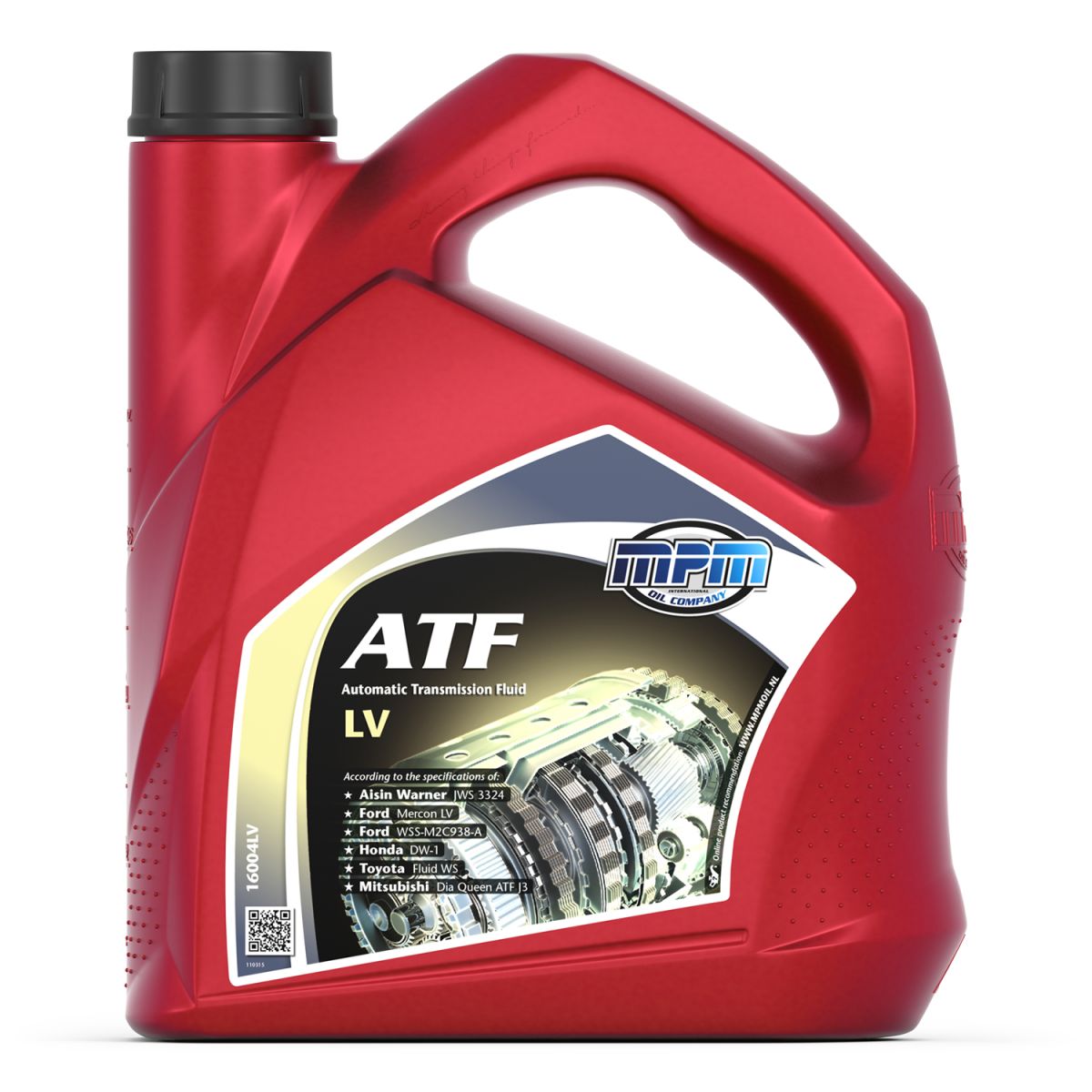

    image.jpeg I am still confused
    Do I have to change it again ?
    Last one I changed it was this:

  6. Mendel Leisk
    61,603
    42,377
    I don't see anything on the bottle that says compatible with Toyota ATF WS. And even if there was, I wouldn't use it. This is just one case to stick with the proprietary fluid, no upside to doing otherwise.

    If you're going to use a product from that company, this one claims to meet Toyota's WS standard:
    Edit: That said, Toyota ATF T-IV (which is, I believe, a variant of GM's Dexron III fluid) has been used in Prius applications before, though - the Gen 1 used it. That said, is MPM ATF HFM (or, for that matter, MPM ATF LV) actually non-conductive? I could easily see these aimed at some more generic specs, and working fine in T-IV and WS's conventional applications, but not the Prius.
    I'd personally run genuine Toyota ATF WS in this application.
    (It is worth nothing that the MPM ATF LV is also specified for Mercon LV, which likely says what it was originally designed to meet, though... and Mercon LV is what Ford recommends in their power split hybrid transaxles.)
    Edit 2: Except Ford called for Mercon V in their earlier power split hybrids (before 2009) - which would be an application of MPM ATF HFM. In any case, I'd expect better fuel economy from using Toyota ATF WS (or probably ATF LV) - ATF WS was thinner than ATF T-IV.

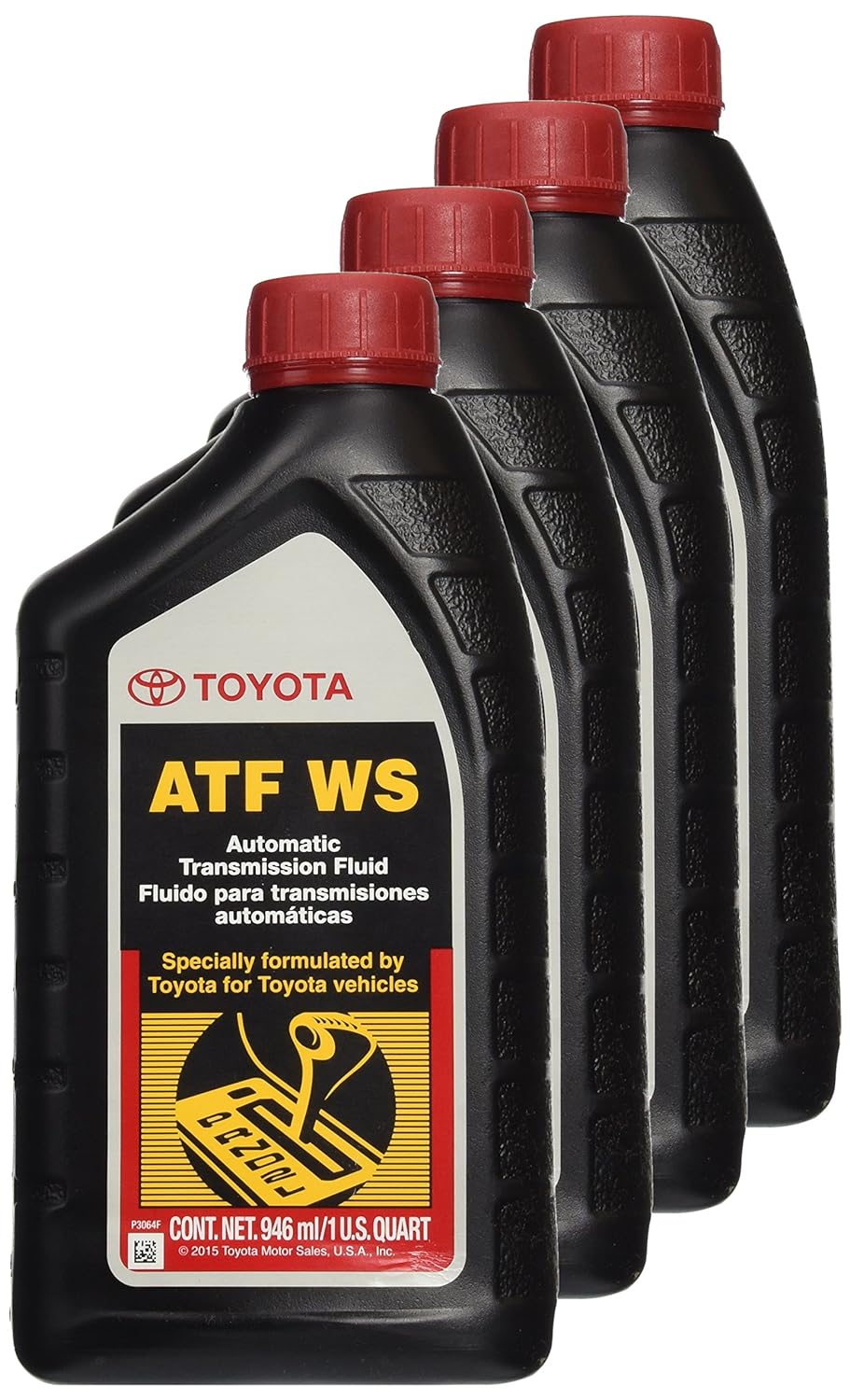

    I will second the above. The correct fluid for the Prius is this

    Third gen and fourth gen North American Owner's Manuals say to use "TOYOTA GENUINE ATF WS" fluid, and caution against using anything else. This is an excerpt from the 2016 manual:
    That said, I've never seen description like the picture you've posted. I wonder if it's in fact the same fluid, or not.
