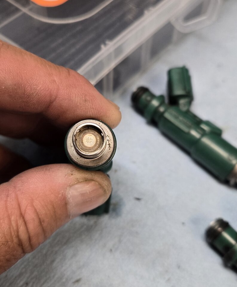

    I had a check engine light with a code of cylinder 1 misfire ....couldn't get rid of it... change the plugs.... and the coils ...went through about four bottles of fuel injector cleaner .....nothing would get rid of it...
    and I couldn't get a smog check because in SoCal and the check engine light was still lit
    New fuel injectors are $100 a piece at O'Reilly and $200 a piece from the dealer...
    The O'Reilly's guy suggested... why don't you just clean them.. good idea!
    Took the car home... only took about 5 minutes to pull them out.. got to be really careful and have a vacuum cleaner with a small hose ready to suck out any crap dust debris before it drops into the cylinder
    They were REALLY dirty!
    Scraped them with some wooden popsicle sticks split in half... and blasted it with throttle body cleaner and shop rags....And they look good as new
    Installed them back in the car...turned it on and the check engine light went away all by itself.. drove the car 200+ miles and no problems.... feels like a RACINGPrius now!... checked it with OBD II...itll pass smog check no problem

    Clean the others also. I cleaned them on my old bmw while back. Fill the port with brake fluid, apply 12V power and blow threw it with compressed air. Immediate difference.
    Did you replaced the O-Rings?
    You could get it professionally cleaned also.

    Yup I cleaned all 4 injectors...
    Bought 2 sets of replacement Orings because thats all they had...but the stock ones looked good so decided to leave them in...hopefully not leaking but will check later
    Is THAT how they work!?...hit it with 12 volts and blast it with compressed air...See!...thanks again!...I was almost certain I had jammed some gunk into the little holes and wasn't sure how to clear them out...ok will try that too!...awesome

    Out of curiosity, has the OP been using something other than "top tier" gas?
    Interesting that 4 bottles of injector cleaner didn't help. Techron or something else?
    Did I read this right, only the outside was cleaned? As in the outlet holes were clogged right at the surface but (apparently) not the innards?
    Danno5060 likes this.
  5. steamroller
    steamroller Junior Member
    Jun 8, 2007
    Yes ran through 4 smaller bottles of Lucas fuel.injector cleaner...thats.2 bottles each in 2 tanks of gas...92 octane from chevron and shell...
    Only the outside was cleaned...sprayed with throttle body cleaner and scraped with wooden popsicle.sticks...im almost certain i jammed some gunk into the little holes...but now that I know how to clean the inside I'm going to try the compressed air method next...
