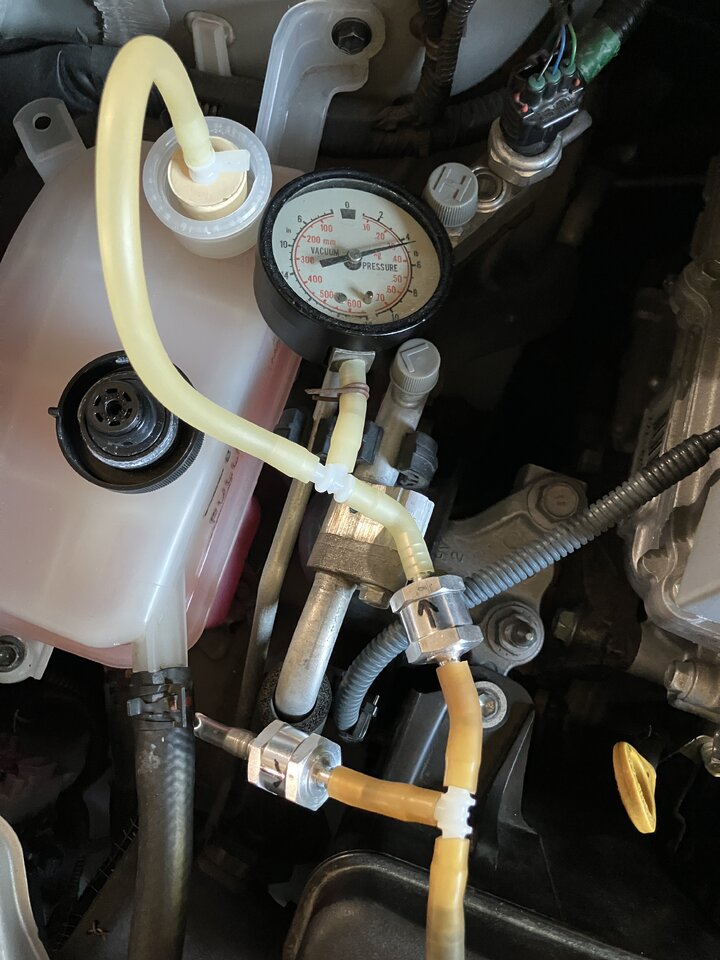

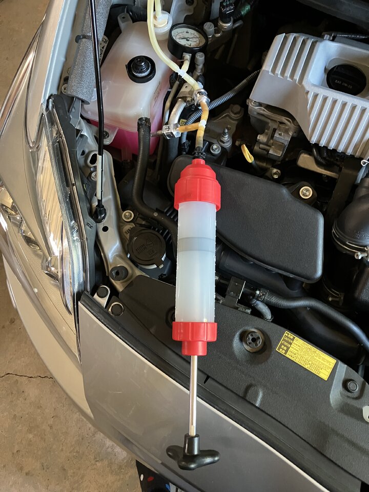

    I'd swap the coils/plugs around, see if the code follows. If not, borescope the combustion chambers, morning after a previous day driving. Preferably with cooling system pressurized.
    Make-shift coolant pressurizing gizmo:
    Also check condition of plugs.

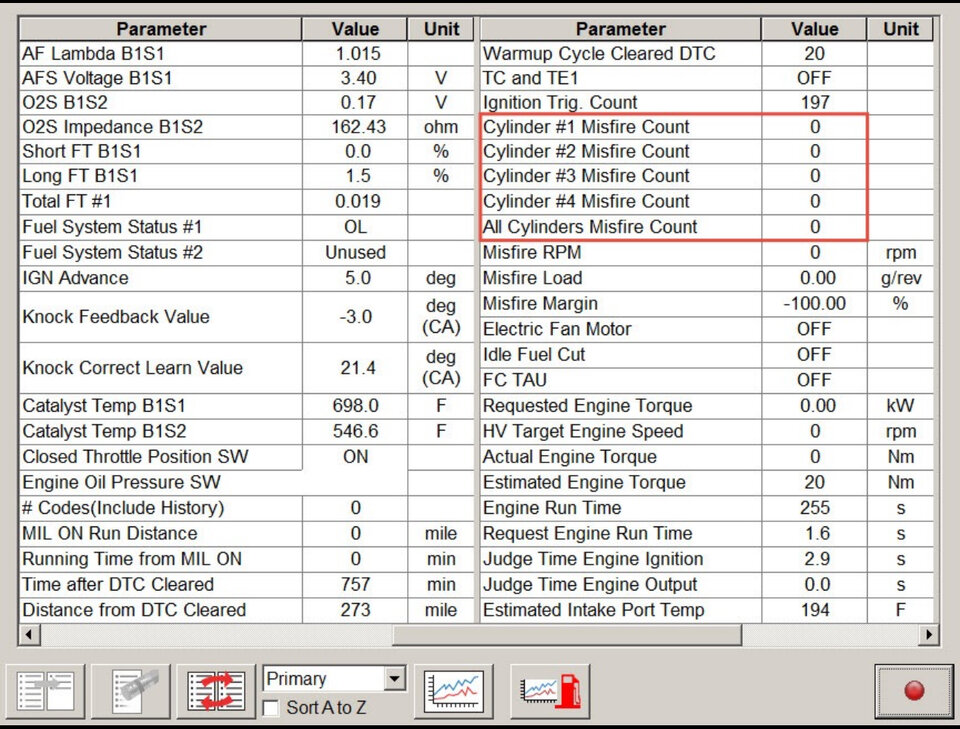

    In my opinion people on this forum announce that your head is blown with insufficient evidence. These engines seem to rattle and misfire due to EGR clogging, bad PCV, and general air intake grunge. In my case, I had rattles and misfires, I cleaned the EGR and slapped in cheapo new plugs and coils, engine runs fine now.
    Proper test for blown head is a compression test , which can be "faked" with a Techstream scan tool in 5min, or proper compression test by removing wipers, coils, and plugs. I got 120psi on all four cylinders. Then I ran a bore scope down into the cylinders for extra verification. After I posted those results, the yapping died down about "your head is blown, maybe it'll get better if I just wait haha". No substitute for proper diagnosis. Internet forums are filled with speculation. Don't let the armchair experts get into your head:eek:.
    Also keep in mind that there's a torque dampening clutch between your engine and trans that tends to rattle. Not a problem unless its totally shot.

    Things are different on a Prius. Putting a camera down the spark plug holes, and putting
    pressure on the coolant system to see if coolant leaks in is the BEST way and most reliable
    way to check for a bad head gasket.
    You can have a bad head gasket and still have good compression. That has been reported several
    times on Prius Chat. 90% of the time it leaks between the # 1 and #2 cylinders. And it's when the engine
    cools off that allows the coolant to leak into the cylinder.
    So just because you have good compression, doesn't mean you DON'T have a head gasket that is failing.
    Yes, several things cause a misfire, but the most common is the failing head gasket.
