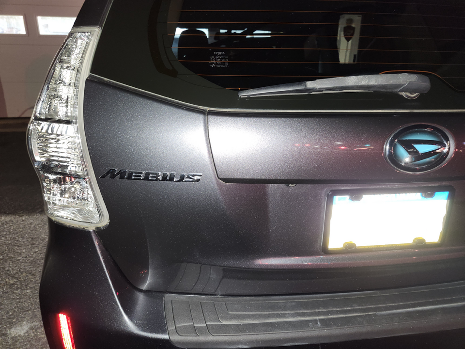

    Here it is with the new badge added. It's a hair lower than it would've been from the factory because the guy was trying to cover up as many of the touched-up scratches from removing the old one as he could, but it's absolutely something only me (or now, you all) would notice.
