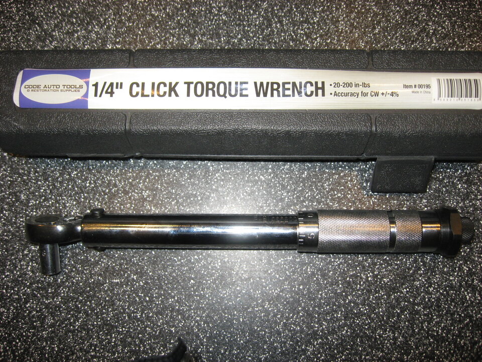

    Yes, a torque wrench is a very wise "must have". Pictured tool is what I purchased when I replaced my hybrid pack.

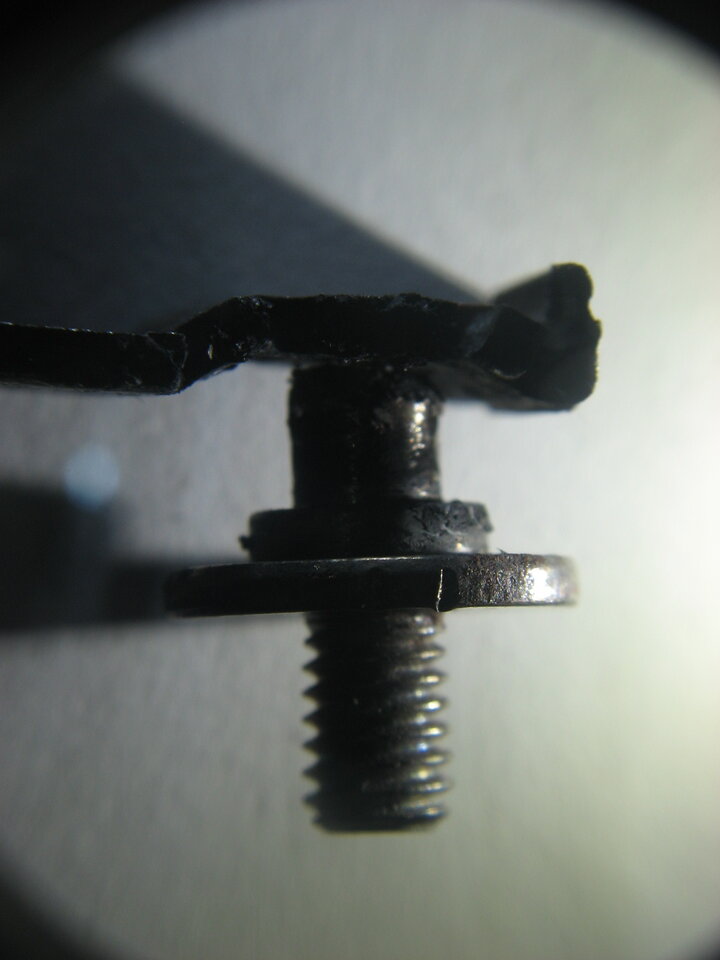

    On to another subject. I was curious if a broken stud could be professionally repaired, so I took apart a bad module. There does not appear to be enough metal to drill and tap for a new stud. :(
